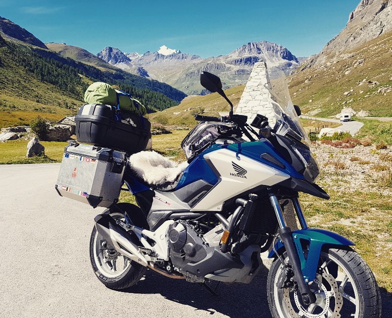

Micksea. love it so far. I traded in my 11000 mile crf1000L AT for it. wanted something more road based and getting a 250L to comvert into something a bit long distance adventure-esque. I've done 2.5k on the NC so far, 1300 of those in the past few days on my month long trip in europe. its carrying me, my panniers, camping gear etc around brilliantly. don't miss the power at all it's so smooth and fun.
