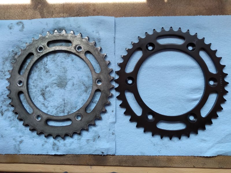

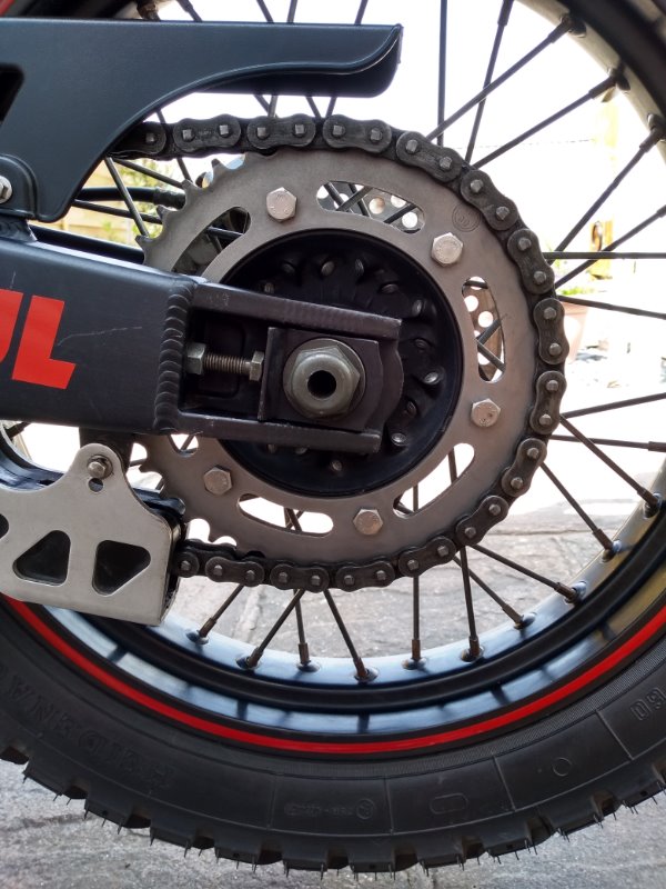

Spent the day tinkering in the sunshine with WK400.
I stripped down the back end, wheel off, sprocket off, spacers out, bearing dust caps out then a good clean and inspection on wear and tear.
Bearings will need to be changed soon, which i have ready, i did the front a while back due to one failed bearing which i think was installed slightly off true. The front was fairly straightforward but not so sure on the back as i haven’t the space to get a drift in to knock out as the inner spacer sits bearing face to bearing face and is flush with the bearing so no lip to catch the drift, any suggestions most welcome.
I also wanted to check the size the rear sprocket as i wanted to try an option away from the OEM. After a bit of research and checking measurements the rear can be changed to a JTR 897 40T, which comes in anodized black, very posh......and the front is a JTF 1322 15T, chain is a 520 110 link which does not need to be JT although they do a nice gold, nickel or black steel version but I will see nearer the time when I change the set, likely to go for split link rather than rivet. JT do a DL X ring chain which the DL means supplied with duel link, very handy.............
I’m pleased to confirm the JTR 897 is the right size.

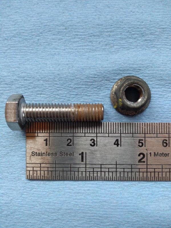

One point I noticed is the JT sprocket has countersunk bolt holes and the original does not so I will get some new countersunk sprocket bolts as well, these are M8 x 33mm although 25mm would be good
A point of ref is I sourced the rear sprocket new for £13.40 and the front for £8.45, i know they are not going to last twenty thousand miles like some premium brands but I’m ok with that for the price

Most times the spacer is just wedged there in line with the bearings from being preloaded when you tighten the axle up, try sticking a long screwdriver down the hole and levering sideways the spacer should shift to one side giving you a lip to hit, then push it to the other side and repeatthe inner spacer sits bearing face to bearing face and is flush with the bearing so no lip to catch the drift, any suggestions most welcome.
