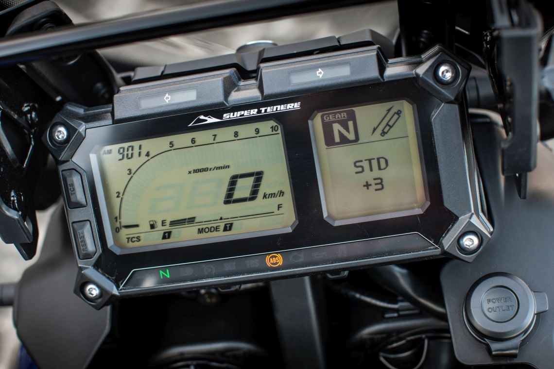

The instrument cluster has seen more significant change, with a boxy, almost eighties design (taken from the FJR) replacing the original.

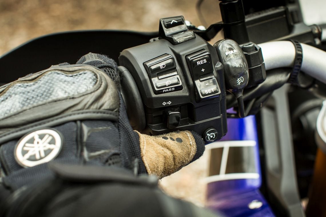

To the left of the screen are the buttons to alter the three modes of traction control and the ABS.
The bike now comes with a gear selector indicator, which oddly has been programmed to read as blank whenever the clutch is pulled in.
This almost defeats the purpose, as to roll into a roundabout or to a junction with the clutch pulled in it’s sometimes handy to be able to look down and see what gear you’re in before letting the clutch out (which most gear indicators allow you to do), but on the Ténéré it only shows the ratio once you’ve disengaged the clutch.
There’ll be some technical reason for it being like that, but we couldn’t see it.
The cruise control is easy to use, however. A button on the left cluster switches on the system (an orange icon on the illuminates to indicate this), then, with its own rocker switch for operation, you press the top half to set it at your current speed, then the same rocker to increase or decrease speed by holding it down.
To deactivate it you can either touch the brakes, the clutch or if you roll the throttle closed and over a slight notch of resistance, that deactivates it too.
Pressing the lower switch on the rocker resumes your previous speed. It’s the same system as on the FJR1300 so is well proven and well tested.

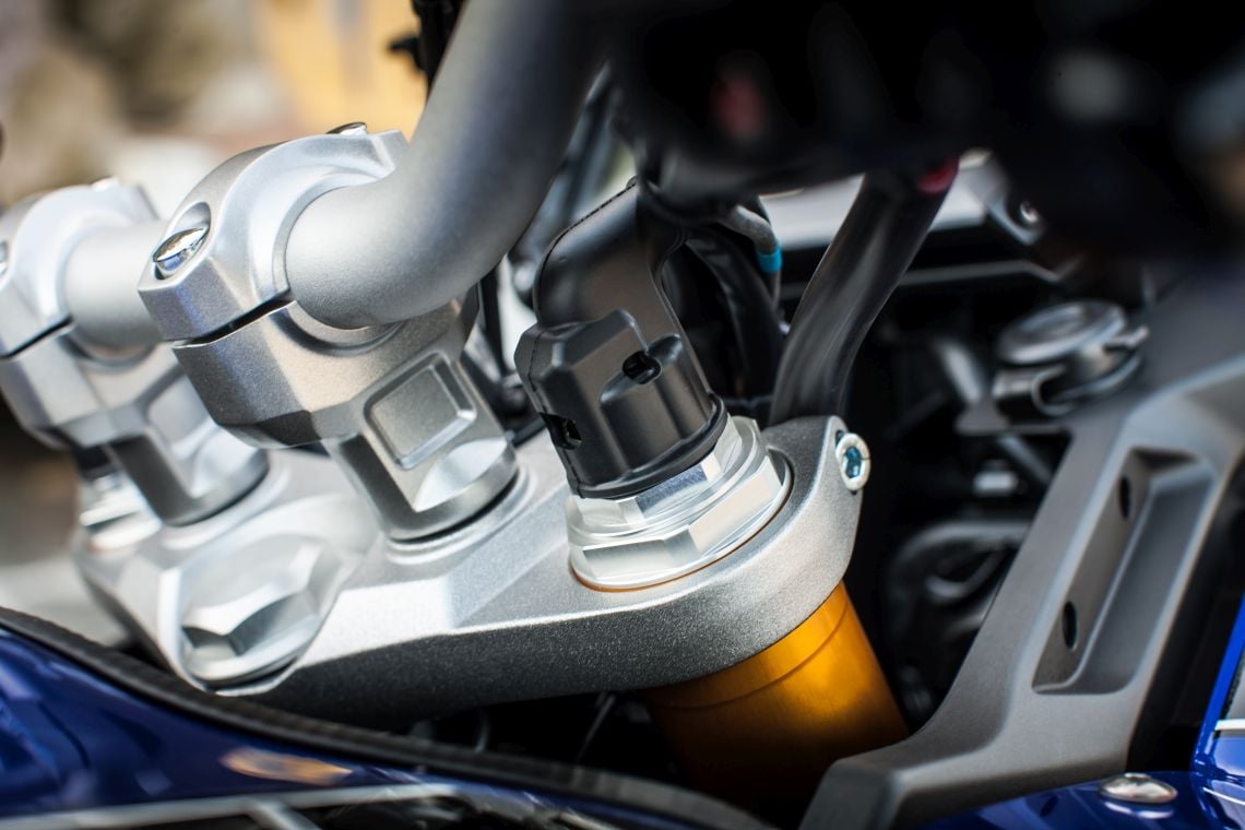

The electronic suspension is also the same as that used on the FJR. It boasts 84 different variables and can prove quite fiddly to get to grips with at first; certainly not as instantly user friendly as on the GS.
The system – once the bike is stationary – gives you four choices of preload; solo rider, solo rider with luggage, two-up, and two-up with luggage. You have to be stationary to adjust these. On top of that you also have the choice of damper settings; soft, normal and hard, which you can adjust on the move.
You are also able to fine-tune these three settings, with increments of +1. +2 and +3, and also -1, -2 and -3. So ‘normal’ +3 is almost the same as it being on hard.
It’s designed to reduce the step between the settings, and like the preload, can only be adjusted whilst stationary. Only the settings; soft, normal and hard can be changed on the move.
To make the changes you have to select the suspension option on the menu screen on the instrument cluster.
You scroll through the options using the trigger button that usually operates the full-beam flash on most other bikes (to flash on the new Ténéré you now press the lower button on the light switch rocker).
There is then a third rocker switch to operate the sub-menus.
It sounds complicated, and it is at first, especially when you want to flash someone out of a junction and end up putting the heated grips on instead.
The worst time is at night, when you’re new to the bike, finding it difficult to distinguish between the three rocker switches and there’s no light to illuminate them so it all gets a little clumsy. Is the left-hand control unit too cluttered? Perhaps.

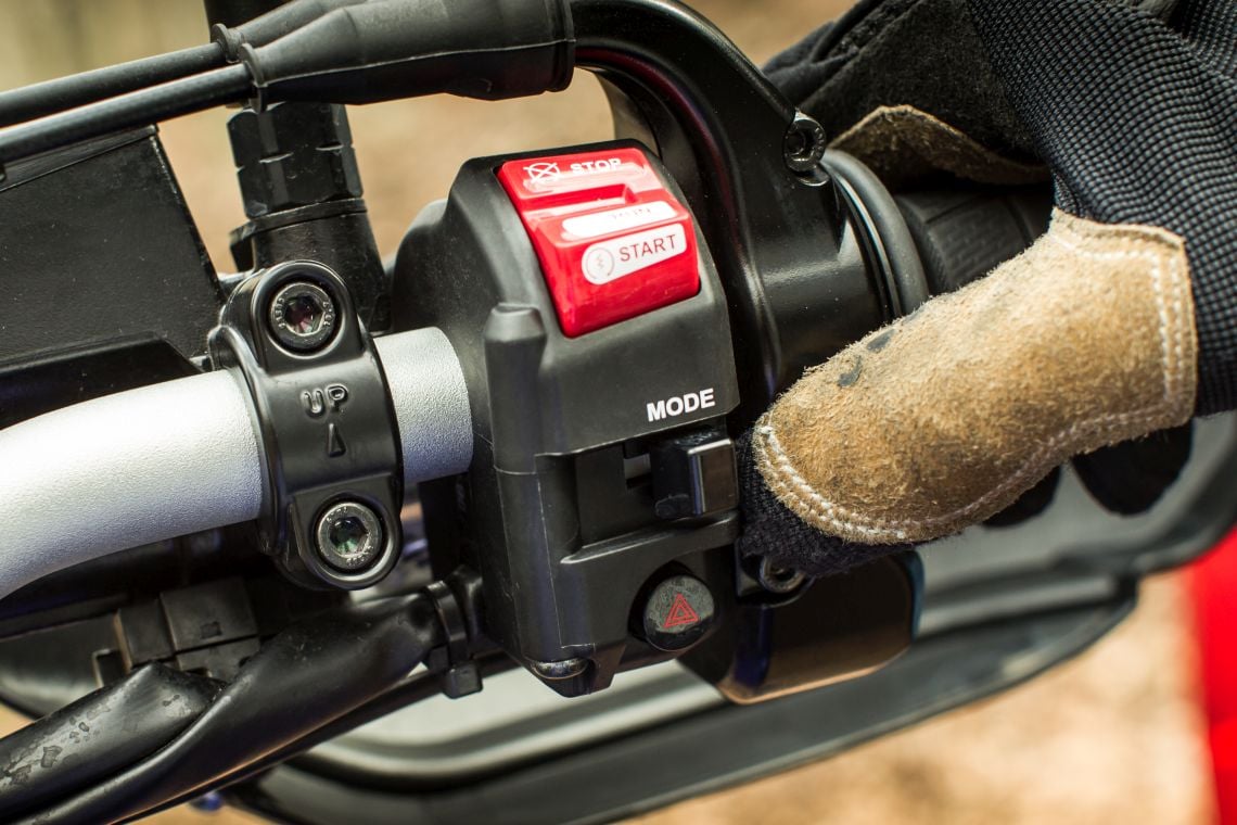

On the right-hand control switch is the usual engine start and hazard warning buttons. There is also the riding mode selector, the choice between Touring and Sport.
This was a feature on the old model, but the settings have been revised for the new one, with mixed results.
Touring mode has been softened to such an extent that there’s barely any throttle response in the initial twist.
It’s like pulling the engine through treacle and takes some getting used to as the instant power delivery just isn’t there.
Conversely, Sport has been made sharper; great for when you’re on it, but too snatchy or abrupt when riding at five-tenths.
It needed a happy medium, somewhere in the middle, or just one good standard settings, as the V-Strom and KTM prove is more than possible.

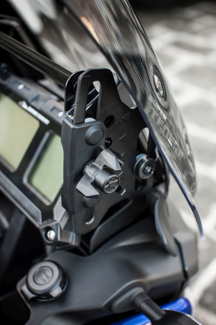

Other changes include revisions to the screen adjustment mechanism, which isn’t the one-handed operation you find on the GS, but instead requires the slackening of two lock nuts, and the edging up of the screen to give it more lift, before re-tightening the nuts. Takes a bit of practice.

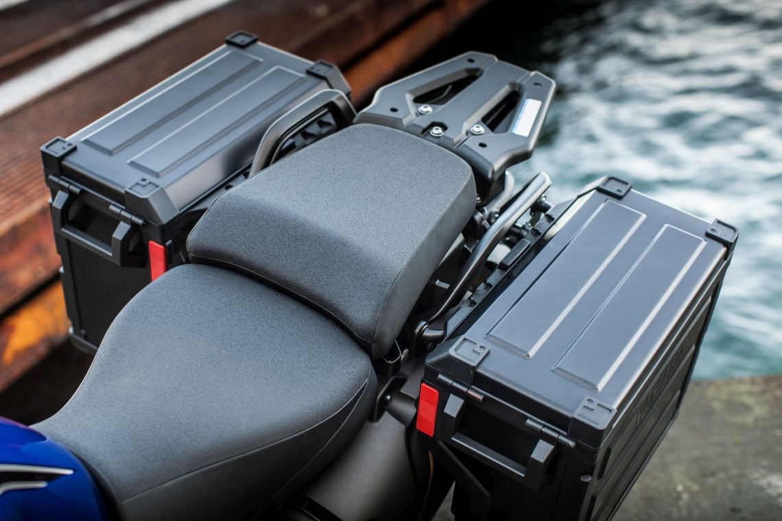

Sadly, what hasn’t been updated are the panniers. Visually they still look good and really suit the style of the bike.
Perhaps the best looking (or at least most discreet) factory option panniers on the market, but the locking system is atrocious, turning the key one way to open the lid, and the other to release the panniers from the frame.
The barrel action isn’t smooth and puts far too much strain on the key, which already feels quite flimsy.
We’ve noticed this a lot on recent bike tests; flimsy keys, the same on the Honda NC750X and to a lesser extent the new V-Strom.
It’s not good enough really, and my concern with these panniers on the Ténéré is that they could easily leave you stranded after snapping the key off in the lock.

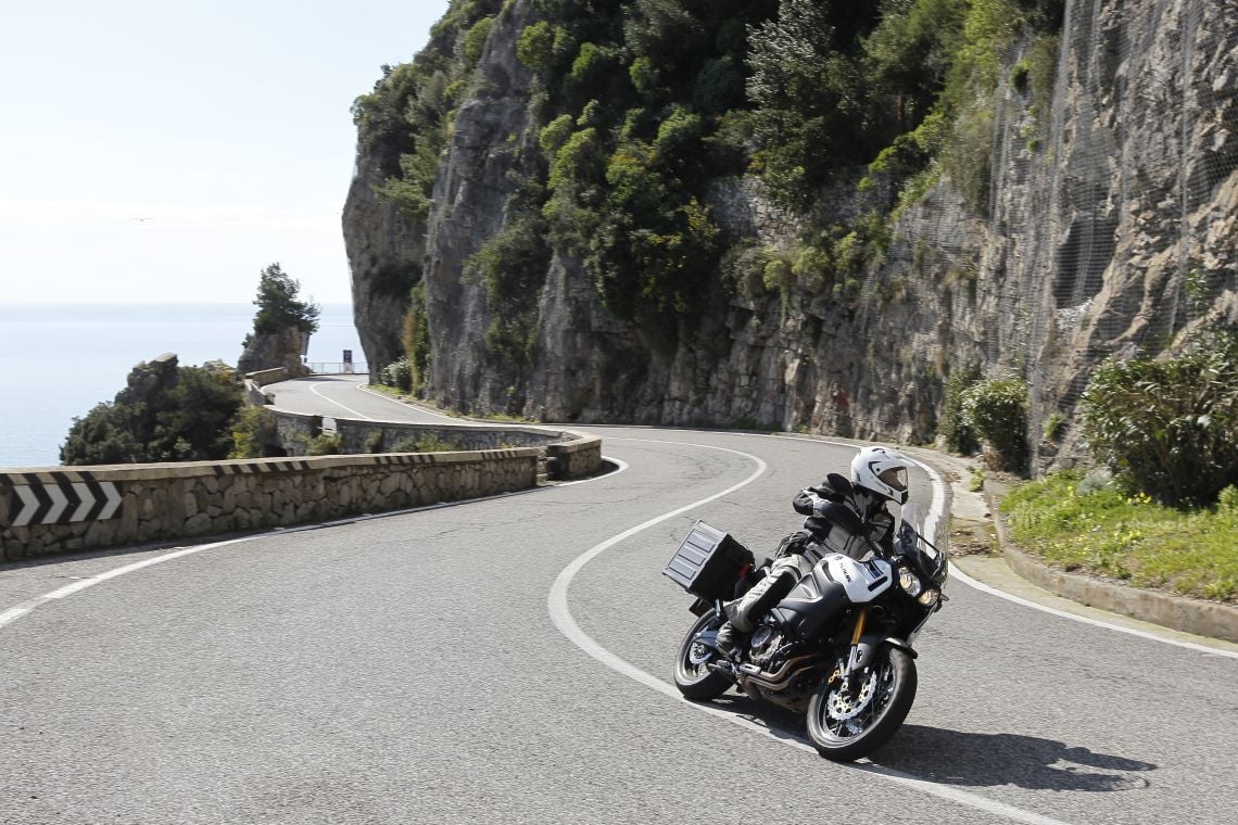

This picture was taken on the SS163, the road running along the Amalfi coast, just to the southeast of Sorrento, Italy.
We flew into nearby Naples, with your best bet just to rent a scooter from somewhere in the city, as the roads around there are gridlocked as they run through the towns, and a scooter would be ideal.
Alternatively, either ride down there on your own bike, or if you don’t fancy that, consider freighting your bike down to Nice with FlyBikeFly, and riding down the Italian coast and back up, taking in this road as you go.
Perfect for a week’s getaway. Campsites were dotted along this route. And plenty of hotels.

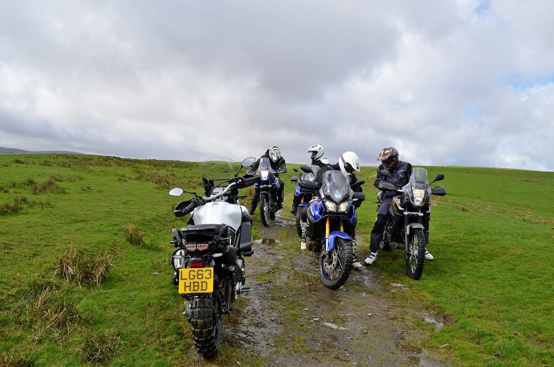

It was part of our own frustrations that we ended up at the Yamaha Off-Road Experience in Wales.
Being invited to the press launch in Italy is pleasant, and the food is great, but it doesn’t give you much chance to ride the bike, especially not off-road, and so having heard that the Off-Road Experience was getting its own fleet of new Ténéré for the Ténéré Experience we inquired as to whether we could go down and give one a proper shot in muddy conditions.
And thankfully Yamaha was able to arrange it.
Rather than one of their own bikes, however, the instructions were to ride over on the standard press bike I’d already been given, where upon arrival it would be fitted with knobbly Continental TKC80s (though sadly no crash bars), and away we’d go.

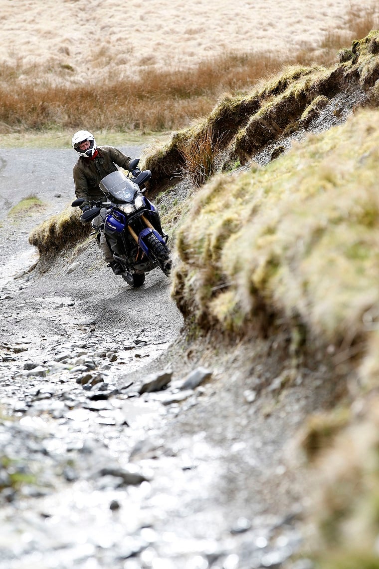

Much as on the road, first impressions of the Ténéré in these conditions were not overly positive.
It felt as though you were stood up on the pegs of a touring bike, with it lacking any finesse or precise manoeuvrability. From the outset, it’s clear to see that this isn’t as competent as a standard GS in these conditions.
That BMW, despite what some might think, really does have true off-road potential – a real crispness about the way it handles in the dirt, and you’re almost able to ride it like a scrambler after a bit of practice.
But this Ténéré is different.
It feels heavy and vague, the steering not as direct or athletic. It certainly puts a lot of pressure on you to get the most out of it.
Things weren’t helped by the touring screen fitted to the white press bike.
Again, it felt like you were taking a touring bike off-road, the screen right up in your face, even when standing.
There was also the nuisance of the exhaust cowling sitting a shade too far forward, meaning that it pressed against your left calf and took you out of your natural riding position.
Again, the issues of that riding mode came in to play; questions of whether you have it in Touring or Sport mode.
Traction control, for the time being, was left on full setting, with the option to turn it off completely, or to a halfway house, allowing a little more slip.
The conditions were a mixture of farmland tracks, with grass strips along the middle, and then more technical sections, with steeper loose shale slopes and moorland ravines, much like you can see in these pictures.
One things certain; the views, and the riding facilities up here in Mid-Wales are stunning.
Mike Beddows tackles some of the trails in this issue’s Green Laning section and it’d be well worth checking them out, whether you come out on the Ténéré Experience or not. In truth, I probably wouldn’t recommend the Ténéré Experience for the novice.
The bike, in these conditions, is too intimidating and you can soon lose your nerve if you feel too far out of your depths. A better option would be the regular Yamaha Off-Road Experience, done on WR250Fs.
Back to the Ténéré and there was a chance mid-way through the day to swap bikes with another journalist, as he’d been riding the standard Z model (without the electronic suspension) and wanted to give the ZE a go.
The difference was night and day.
His bike had been set up by the school and so had the standard screen, and the bars had been rolled forward to give a much better posture for being up on the pegs.
The suspension also felt much more suited to the conditions; firmer, more controlled and direct.
I later realised (when back on the ZE) that the settings for the preload are too soft, and that upping the preload to ‘solo rider with luggage’ does wonders for the bike’s characteristics, both on-road and off.
On this bike (the blue Z), set up the way it was, the Ténéré really started to ease me into the flow. It still isn’t as sharp as a GS, but certainly, on the forest trails it was composed and agile, the traction control really subtle and non-intrusive.
The Ténéré doesn’t give you the option to turn ABS off, but I would probably have left it on anyway.
Probably the best bit about the Ténéré off-road is that low seat height and that low centre of gravity. It really keeps you balanced and it’s easy to just dab a foot if you need to.
I shouldn’t tempt fate, but it seemed like a difficult bike to crash and to drop (though one journalist did manage to crash two bikes), thanks largely to that low seat and you being able to get both feet firmly on the ground. It’s a good thing and inspires confidence.
Worth mentioning are the tyres. The white ZE was running TKCs, the blue Z was running Metzeler Karoo 3.
It was hard to tell the difference in the dirt, but on the road the Metzeler’s were far more pleasant, riding more like a regular road tyre, whereas the TKCs would rumble and vibrate at low speeds (though the KTM 1190 fitted with the same tyres didn’t suffer the same symptoms).
It would be the Karoo 3 for me. In conclusion, the Ténéré off-road is best suited to fire trails and the lighter stuff, however, it can do the harder stuff too, and like riding it on the road, the bike gradually gets under your skin, and at the end of the day, you’re actually quite fond of it.

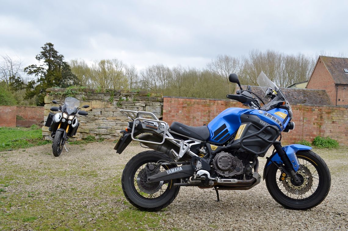

Rob Kelly owns a 2011 Super Ténéré with a few accessories from the Worldcrosser catalogue.
He’s done 24,000 miles on it, riding it for two and a half years to France and Belgium and is about to do the Pyrenees.
Rob has also done 540 miles in SA on a Ténéré, from Swaziland to Johannesburg and back, including 250 miles off-road.
We invited him over to have a ride of the latest bike; to see what he thought… “The power delivery is smoother low down, with less snatch than there was before.
Braking still needs to be done with a fair bit of pressure, it still taking a lot of effort to stop quickly. Overall the bike feels smoother, possibly because of the rubber-mounted bars.
Off idle touring mode feels more responsive, but down low there’s still a bit of lag, maybe even a bit more than before.
Sport mode feels good and very responsive, almost catching me out on one occasion. In Sport mode, it’s almost like my bike rides when I run it on 98 RON.
Touring is much better though, and capable of chopping in and out of traffic.
I spent ninety percent of the time in touring mode. The new wing mirrors I don’t like so much. Rear visibility is reduced. The new cruise control however is brilliant and works really well.
The suspension in normal setting was too soft (preload was set at single passenger, with Rob weighing 15 stone 8lbs) making the bike wallow quite a bit.
I imagine most riders would ride it in hard setting. I like the new clocks, the additional information including the fuel range is handy.
The heated grip operation is also a huge improvement over the old model, as on my bike you operate with an unsightly dial on the handlebars. Overall the bike is a big improvement over mine.
Even the traction control and ABS seem to work better, and the whole bike just feels smoother and a little more refined. I’m hoping to upgrade at the end of the year. Another blue one I think.”
