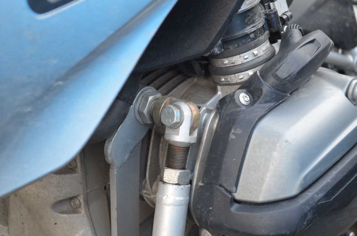

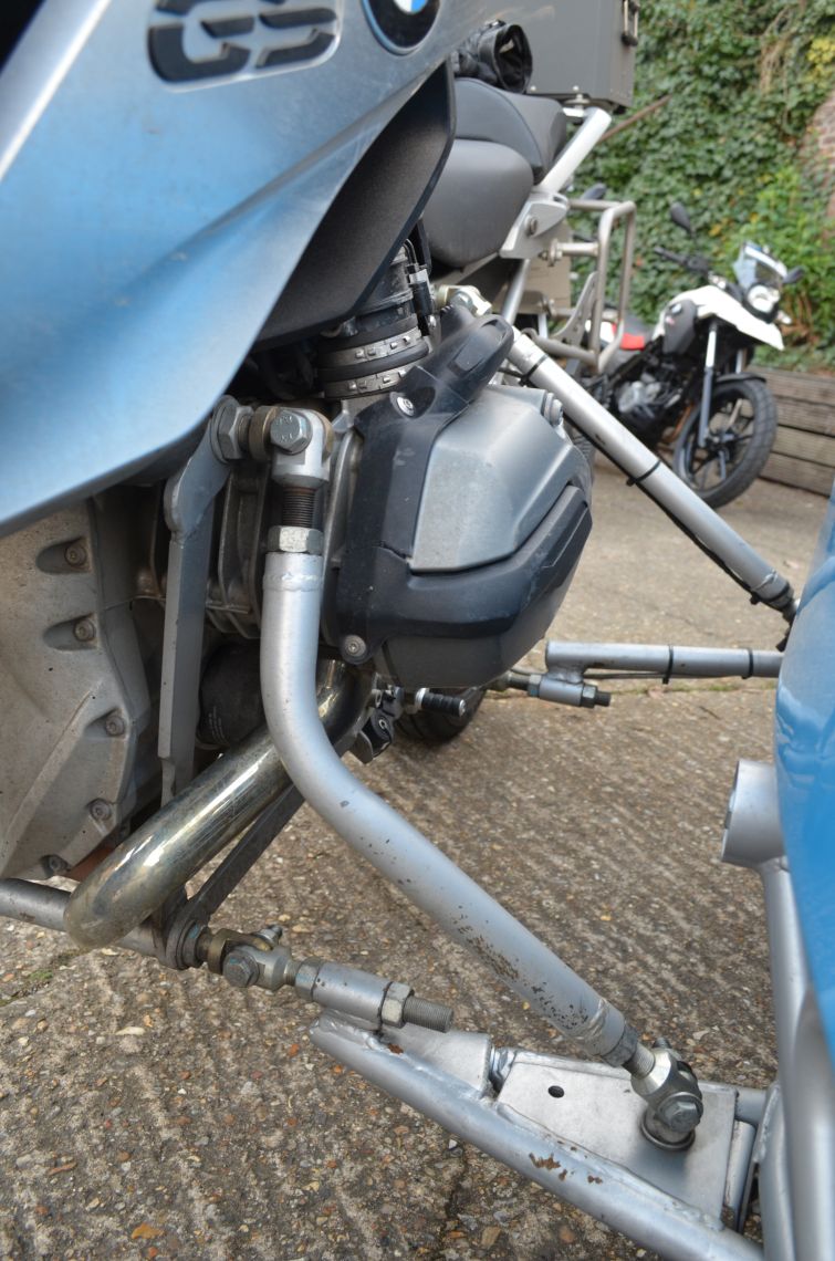

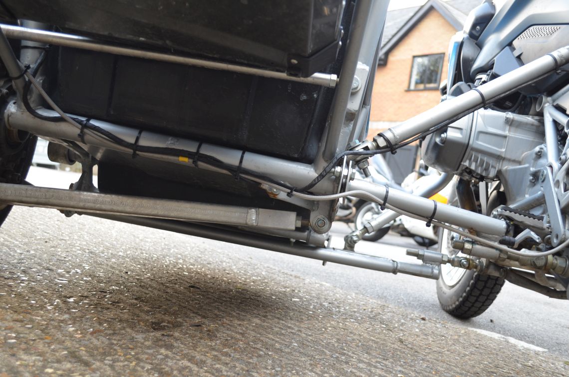

So it’s a Watsonian Squire cradle, the linking arms are made by a Dutch firm, and the shell is made where?
Watsonian builds the frame to our design and spec, as well as the link arms. EZS in Holland manufacture the additional brackets for the bike. We build the shell.
What materials are the cradle and linking arms made from?
Steel tube.
Is it correct that the sidecar and bike tow in at the front, so their noses are slightly angled towards one another? If so, why?
The sidecar wheel and bike wheel do toe in. The bike does also have a slight lean outwards. These adjustments make turning easier, but one way more so than the other.

Is it correct that the rear brake on the bike operates the sidecar brake?
We hydraulically connect the bike’s rear brakes to the sidecar brake.

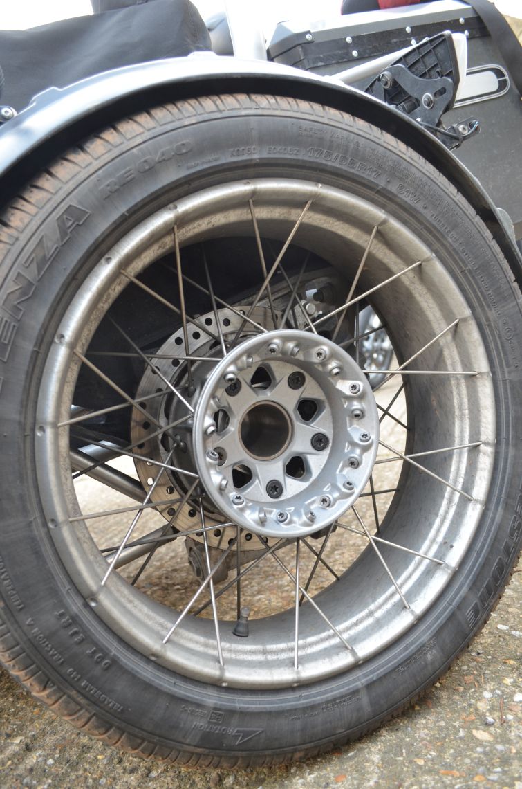

What’s the sidecar hub from?
The sidecar hub bearings, wheel carrier disc and caliper are from the GS. The hub itself is CNC’d by Harris Performance.
Where’s the sidecar shock from?
The sidecar was designed to take a GS rear shock. We currently use a Wilbur’s shock with a 50 percent softer spring rate than standard.

What’s the benefit of running it on car tyres?
Longer tyre life.
How do you connect sidecar electrics to the bike?
Any problems with that? We retain all original connectors on the bike’s main loom and use the appropriate connectors to make a loom that terminates under the bike seat with two waterproof terminals in the sidecar loom that attaches there.
