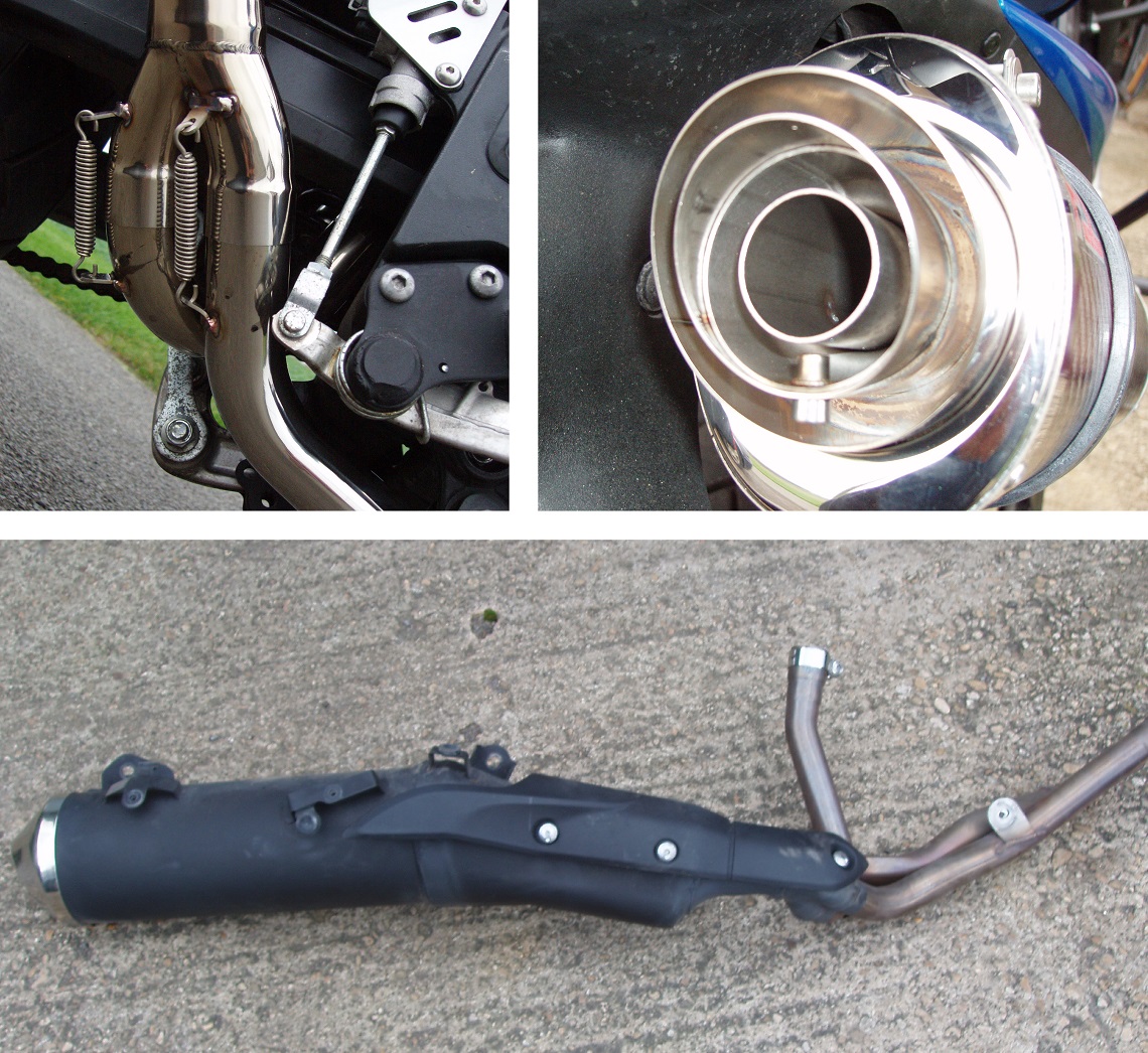

650XTDetailsTop left: The new Fuel Exhausts system pipes
Top right: No doubt it’s louder with a raspier sound
Bottom: The original V-Strom exhaust system

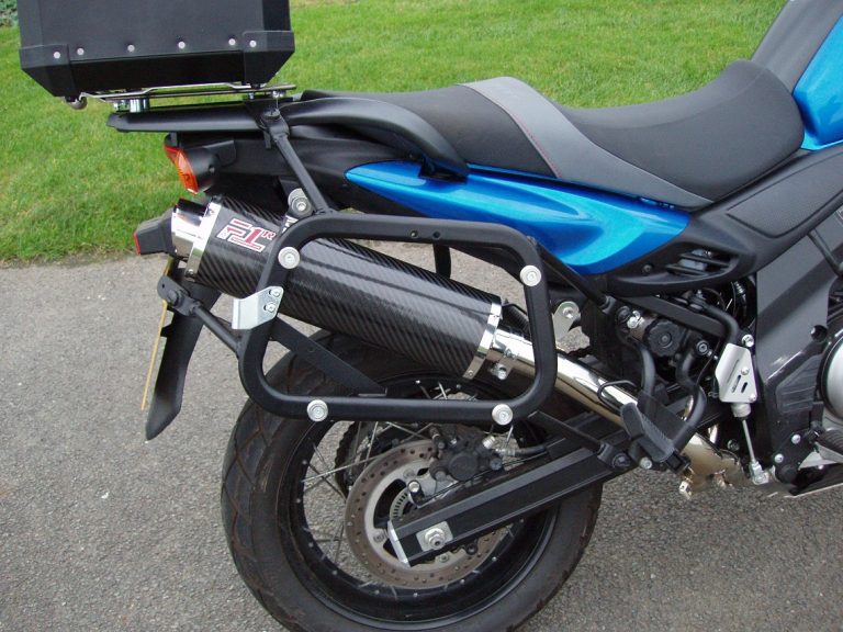

After manhandling the beast off the bench and onto the drive it was time to fire it up. It sounds great, the main difference being that it’s raspier than the standard kit.
After getting suited and booted I set off on a test ride, the bike felt more responsive from the start, crisper, as if a few horses had been added.
Sure it’s a little louder, but I’ll ask someone to follow me to find if it’s acceptable.
