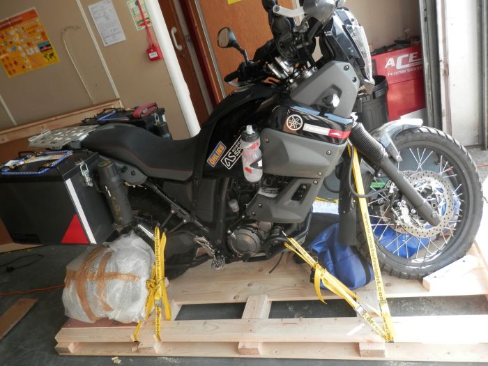

If you are travelling as a group then a dedicated container with no other cargo can be economical. The bikes don’t need to be fully crated in this case which can mean a saving. We do recommend at least palletising the bikes and then securely lashing them into the container. However, when a bike is shipped in a shared container with mixed cargo the bikes should be fully crated for protection and this can be costly.

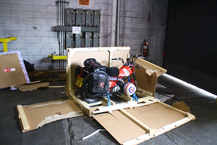

Palletising a motorbike for freighting

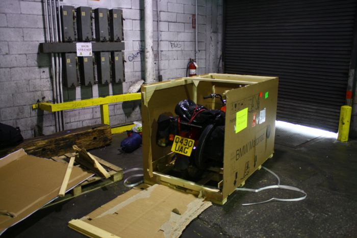

Some travellers like to crate the bike themselves to save money and if you are one of these people there are a number of things to consider. A person licenced to sign Dangerous Goods Certificates must be able to inspect the bike to confirm that it meets the aviation requirements. The wood content must be treated to ISPM15 standard and bear the Forestry Commission stamp confirming that it has been treated (click here for more information).
If cargo arrives at a destination and the wood doesn’t bear the stamp the local authorities might require the crate to be destroyed by the health department at your expense. They could also insist that the bike be returned to origin intact at your expense and even more alarmingly, they also have the right to destroy the crate with the bike in it.
When using a used crate from a dealership do try to use one of a suitable size. If you have a sports bike or a relatively small bike, a crate that was designed for a Harley or a Goldwing could cost you 30-40% more in freight and handling charges than you would need to spend by using a professionally made crate.
