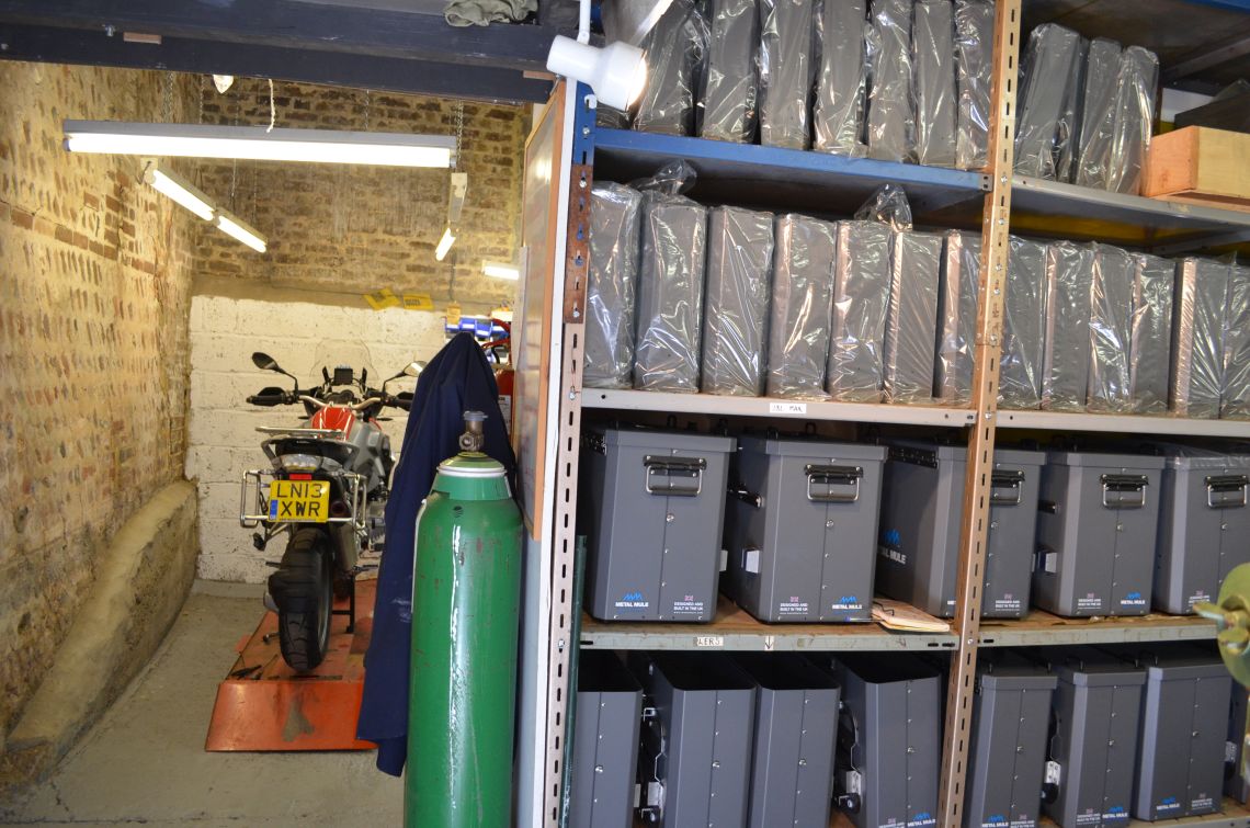

To look at it from the outside you would think this is a multi-million-pound operation with high tech facilities and a bank of machines to do the job. Instead, Metal Mule HQ is a barn down in Hassocks, West Sussex, not far from Brighton.

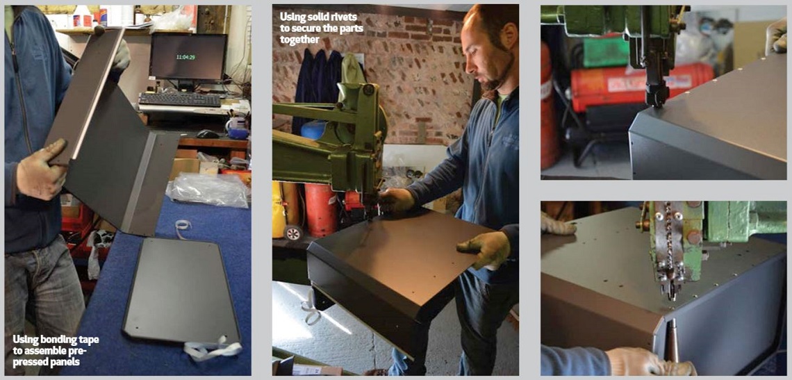

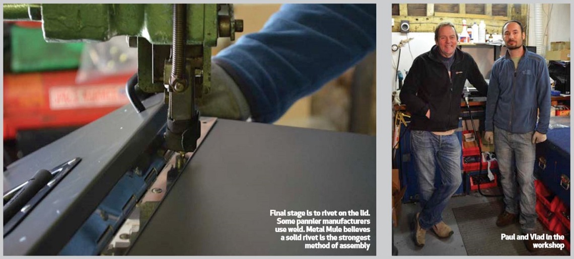

The strength of the Mule comes from the absence of welding. Instead, the base and the two half-shells of the side walls are pressed 2mm aluminium, pop-riveted together using solid rivets, Paul certain that they are a stronger option than welding; ‘You don’t see welds on a plane,’ he suggests.
The real intrigue for us was the man making them, a Mr Vladimir Keselak, who for the past four years has personally assembled every single Metal Mule pannier sold, really putting a face to the product and him doing it with a real pride that he was helping travellers, in his own small way, live out their dreams. It was fascinating to see him work and watch the panniers take shape.

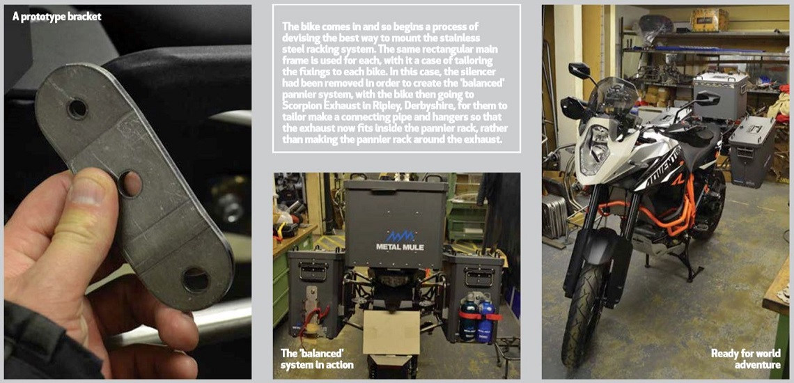

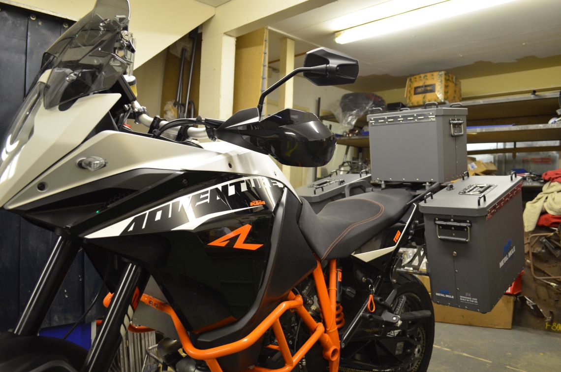

Having taken a tour of the Metal Mule premises over in West Sussex, we rode over to Renntec in Dorset to have a look around there, finding in the workshop a KTM 1190 Adventure R (not the same one as featured elsewhere in this issue) being measured up and kitted out with a racking system ready to go to market.
It was interesting to see this stage of development, Andy, the technician, working out the best way of getting the panniers to sit right and integrate with the design of the bike.
Unlike other pannier manufacturers, Metal Mule go the extra lengths to overcome the lopsidedness you can often get with hard panniers, where a protruding exhaust forces one pannier to stick out further than the other, or one pannier to be smaller than the other, or, as some manufactures such as Jesse do, cutting a recess into the pannier, to make it mould around the exhaust, and in doing so rob the pannier of much-needed space.
Metal Mule’s solution is to design the exhaust around the pannier.
They do this by removing the muffler, shaping and designing the pannier frame so that it is perfectly symmetrical, and then sending it all off to British exhaust manufacturer Scorpion who customise the pipework and fit one of their own slimmer cans, to tuck the exhaust in the gap left by the pannier, the result being a perfectly balanced bike, with the same sized panniers on either side, and both sticking out to exactly the same lengths.
Of course, it’s not the cheapest option, bringing the complete package closer to £2,000, but what you get for that is a tailored design and a lot of care and attention.
Standard brackets will also be made, for those not wishing to buy the aftermarket exhaust, but the system won’t be balanced.

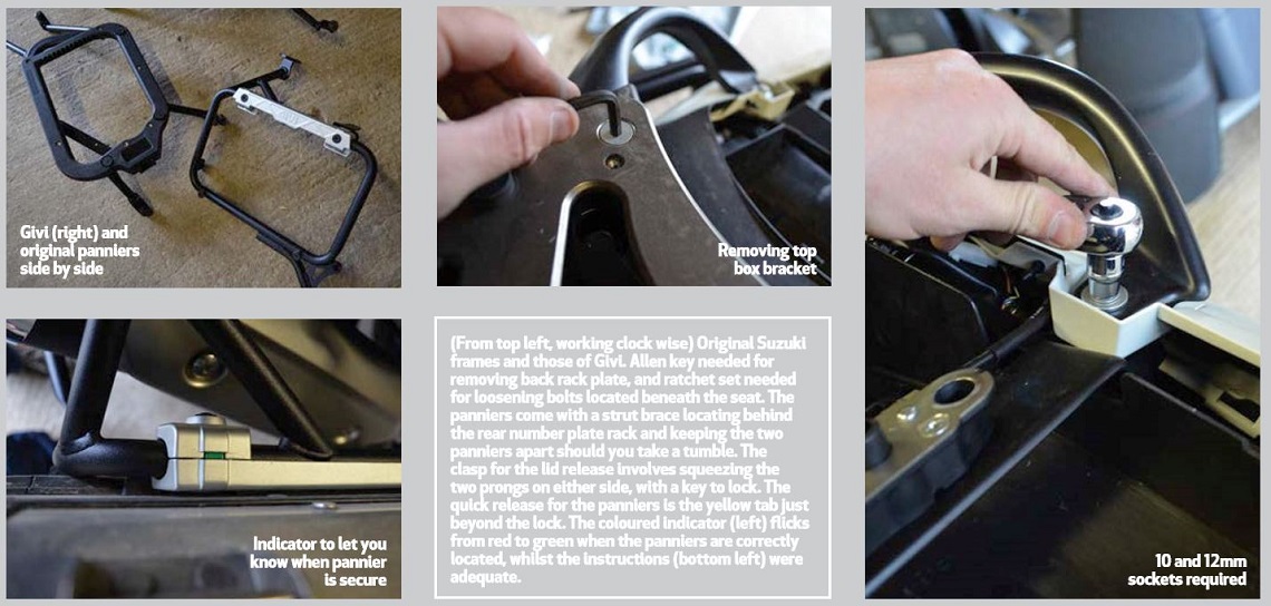

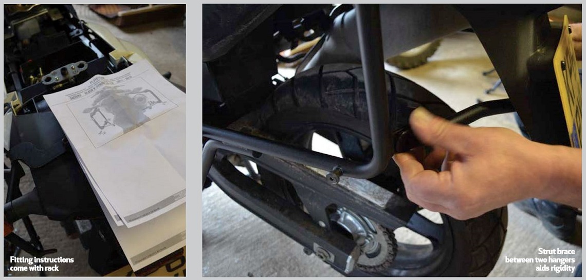

The first job was to remove the existing Suzuki pannier rack frame, requiring a socket set and a couple of Allen keys.
Taking photos as you go – in order to determine the sequence of reconstruction when reassembling – is useful, especially when spacers and different bolt types are used.
With both racks on the ground, it was a good time to compare them. The Suzuki’s feel a little more robust and better finished, something that matters when the panniers aren’t on to hide them. But the Givi’s racks are adequate.
A simple instruction sheet was included with the panniers, with it taking a little time to figure out the configuration.
A spot of hammer work was required to knock one of the struts into place, something that was annoying, but having spoken to another pannier maker recently it seems common for the subframe on any bike to suffer some intolerances from the factory, sometimes an allowance of 10mm for some manufacturers (mentioning no names), meaning that it might be likely for you to have to give your pannier racks a whack too.
What we liked about the pannier racks on the original Suzuki system was the quick release bolts, spring-loaded, requiring a push with a screwdriver, then a twist and the bolt would come out. They were functional and secure.
The Givi racks come with regular bolts, that whilst not as efficient, were still easy enough to fit with a couple of tools.
Once all bolted down and the rear rack put back on it was time to mount the panniers. The system works with a spring-loaded lever that you pull to release.
A coloured tab flicks between red and green to let you know when the panniers are firmly secured.
Once on, the panniers look purposeful, reminiscent of the Touratechs on the KTM 1190, coming, as they do, with handy loopholes on the top, and replaceable corners that can be screwed on and off.
The slight problem, as with many panniers fitted to bikes not originally designed for them, is that one side (the exhaust side) sticks out further than the other, but there’s not much you can do about that.
On the V-Strom, we fitted a 48-litre to the non-exhaust side, and a 37-litre pannier to the other, though the exhaust side still protruded further out than the other, giving a slightly unbalanced look, but again, there’s not really much you can do about it (the imbalance was less notable on an R1200 GS we later saw the panniers fitted to).

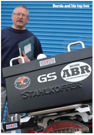

Not far from us, over on the outskirts of Birmingham, lie the headquarters of Stahlkoffer; a funny name given to a pannier company owned by a Brummie called Bernie, but it certainly does the trick of sounding suitably exotic.
Bernie started the company seven years ago having had enough of his previous career of teaching French as head of the department.

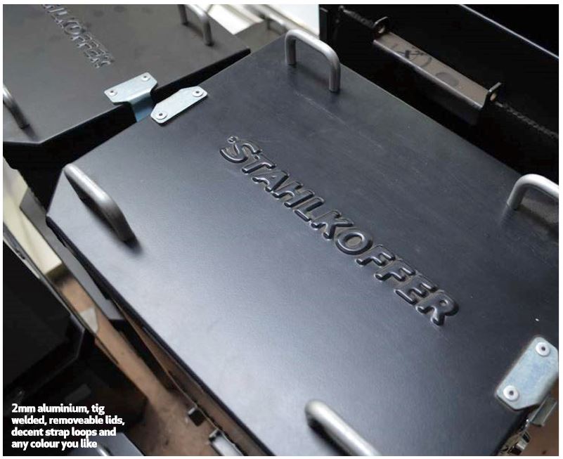

Bernie moved into the business of panniers and devised a very simple and robust design using 2mm aluminium, folded and then tig welded, attached to the bike with a simple pin system, soon to be replaced by a ‘quick release’ buckle meaning you won’t have to open the pannier lid to detach from the racks, a feature that is ideal when using the panniers in the rain, saving the contents from getting wet.
The frames are mild steel, sandblasted and plastic coated, using a universal hoop which has been known to take other makes of pannier as well.
The mainstay of Bernie’s trade are the 1150 and 1200 GS, the Tenere 660, the Triumph 800 XC, the Transalp and the V-Strom 650.
Whilst those are the bread and butter, Bernie is able to tailor his racks to fit any bike brought down to the factory.
You can almost request to have the panniers powder coated any colour you like, and best of all there’s no extra cost for this, it’s just a flat fee of around £625 for the larger volume Stahlkoffer and £600 for the slightly slimmer CityKoffer.
Unlike Metal Mule with its ‘balanced’ system, Bernie gets around the issue of protruding exhausts and such like by having a slightly slimmer pannier on that side.
So the Stahlkoffer is 37-litres on one side, and 40-litres on the other, whereas the CityKoffer is 30-litres on one side and 33-litres on the other.
There’s also a Sport variant of each, offering a slightly narrower fit. Bernie also does top boxes, engine guards, bash plates and side stand extenders.
He’s had people using his panniers on round the world trips and takes pride in them being an affordable, well-constructed bit of kit that isn’t out of the price range of most people.
A twelve-month warranty is provided, inner bags are available, and all fasteners are stainless steel.
The Stahlkoffers won’t win any awards for style, but they are a genuine solution to storage needs at the value end of the market.
