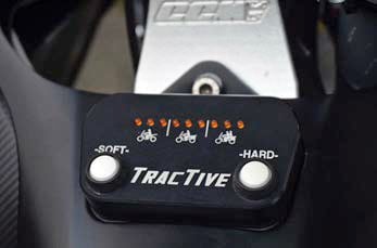

How does the (optional) electronic Suspension work?
Tom Glazemakers: It’s the same unit, just that the buttons on the tank do the clicks, with eight stages, or nine buttons. It’s simply automating the process of turning the adjuster, making it possible to do whilst driving, to take into account luggage load, carrying a passenger, changing your balance, or the terrain you’re riding on.
