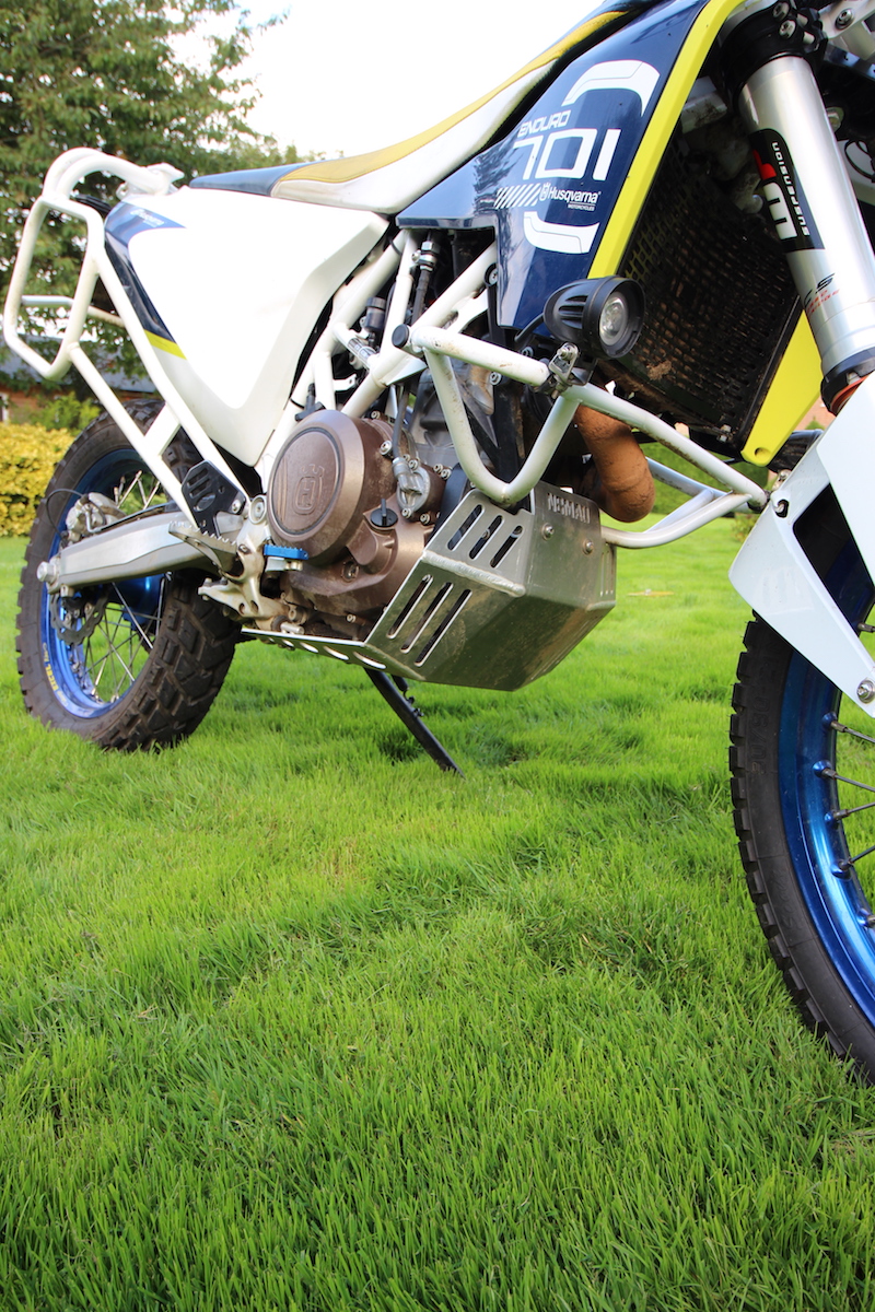

Aad isn’t too keen on the plastic fuel tanks which form part of the 701’s frame. Getting around these for robustness and luggage carrying capabilities required a lot of engineering thought, but the general consensus amongst the duo was that, while the 701 had problems, none of them were too difficult to address, especially with Husqvarna Holland on hand to help with any queries. In fact, they even assisted them with the design of the pannier mountings, which effectively give an aftermarket subframe with the weight of the luggage being diverted to the rear footpegs.
Despite the improved luggage carrying capabilities of Nomad ADV’s modifications, Aad rightly points out, if you really need to carry huge amounts of gear, buy a bigger bike!
The guys were also unimpressed with the standard bash plate, which leaves an awful lot of the engine vulnerable, and when the base bike is built for lightness, engine parts are light magnesium alloy, so protection is essential.

At the core of the Adventure Tower design are wind protection and a home for your GPS. The construction is of aircraft-grade aluminium, and the entire nose cone is bolted together rather than welded. The reasoning for this? If anything breaks it can be replaced using a spanner and socket.
