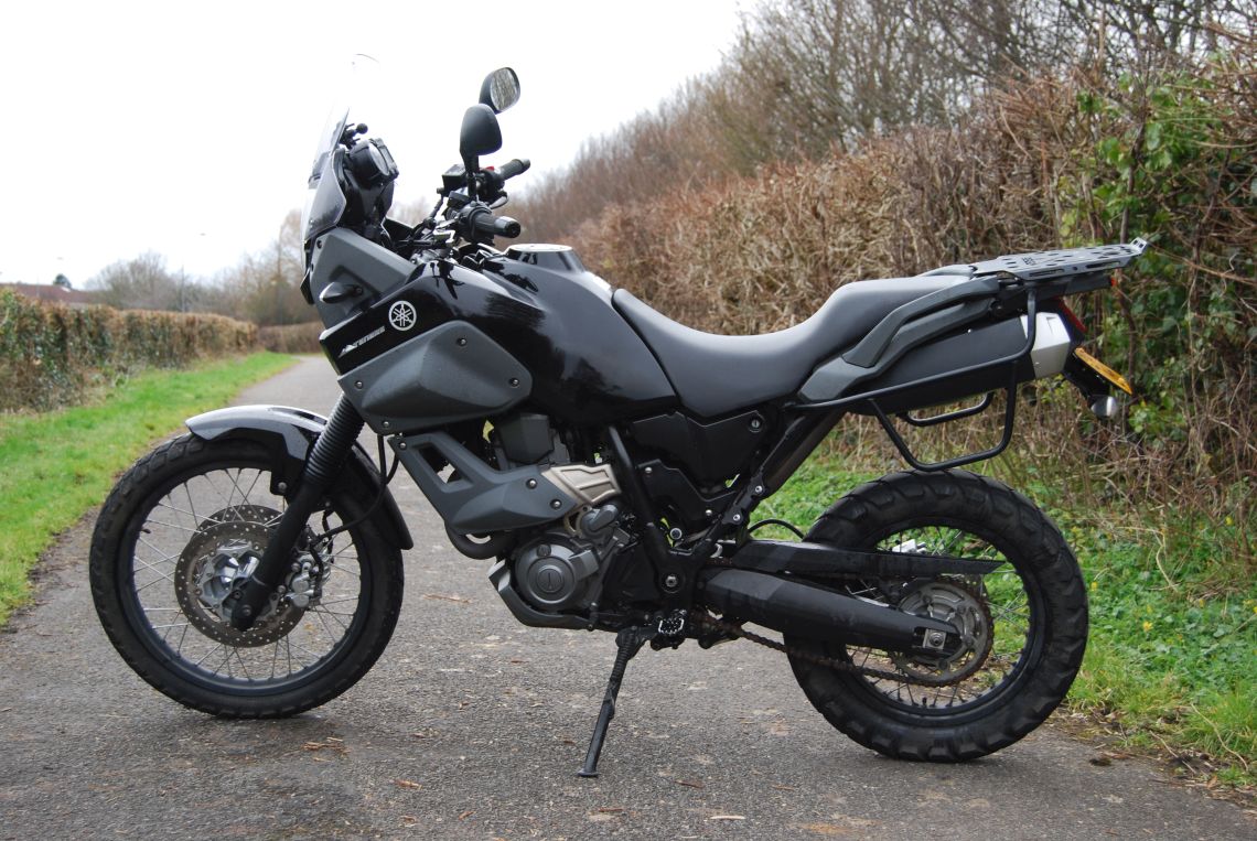

So that’s why only a week after deciding on the plan I was piloting a rather shiny and well preserved 2011 Yamaha Ténéré from my local dealership. With only 9,000 on the clock, a useful selection of aftermarket add-ons and a cracking deal thanks to the fact I used to work at the dealers, pulling the trigger on the XT had been an easy decision.
It was big enough to take on extended mileage on the blacktop, tough enough to take on the off-road sections thanks to its well-documented off-road pedigree, and perhaps most importantly, I’d always liked the purposeful, praying mantis-like looks and stance of the Ténéré.
With Euro 4 regulations consigning the bike to history, then the last incarnation of the single-cylinder XT660Z has future classic written all over it.

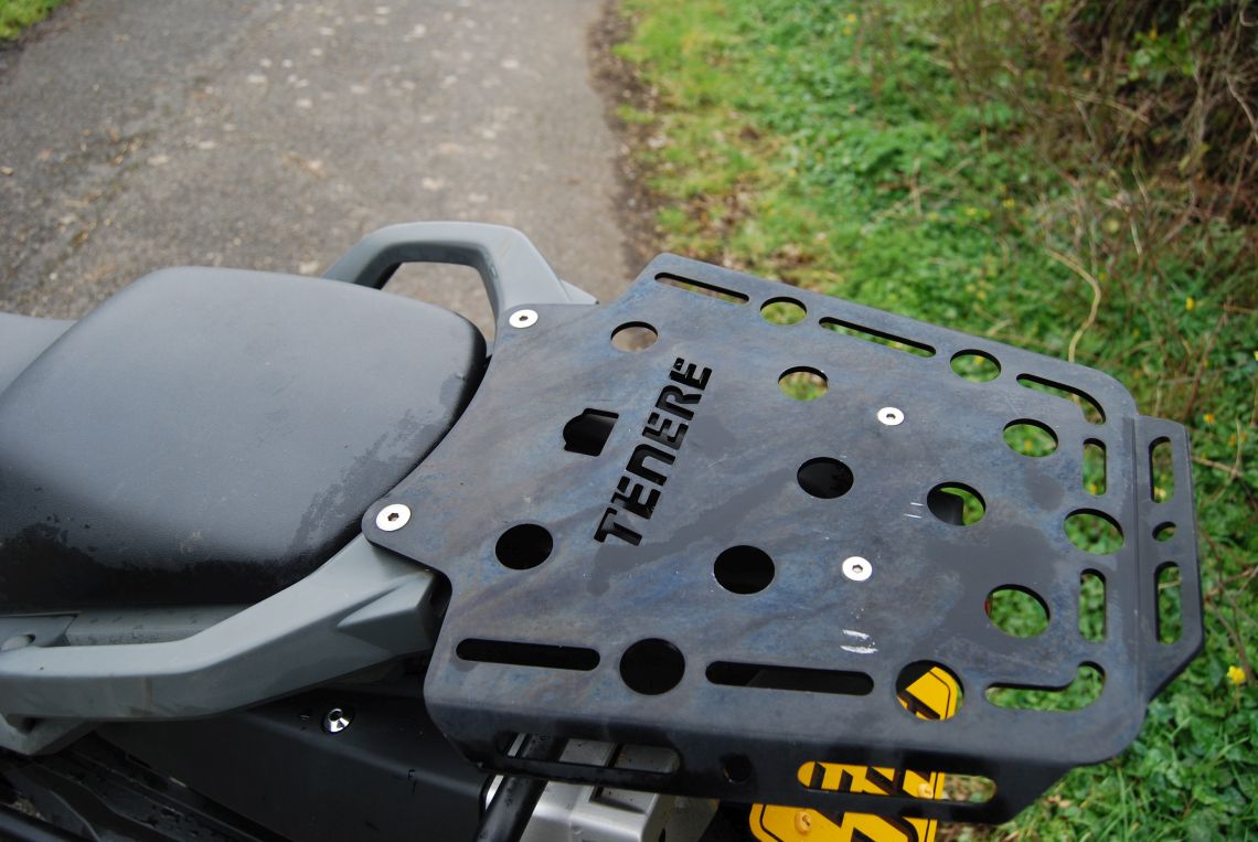

On the luggage front, there was a set of SW Motech soft panniers and fitted racks, and a goodsized baseplate rack at the rear of the bike suitable for a top box or more soft luggage.

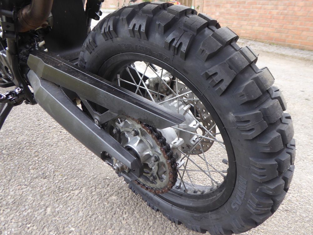

The tyres were the obvious place to start as the fitted Metzeler Tourances were far too road biased to offer much off-road confidence. With the myriad of tyres on offer in the adventure sector I took a stab at the Mitas E09s as a suitable starting point, so a swift call to Classic Enduro in Bristol had the hoops on their way.
Suspension Adjustment
Suspension Adjustments

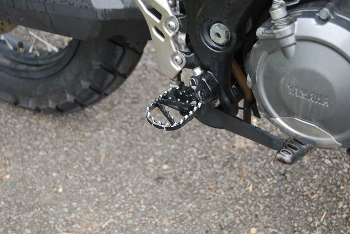

While waiting, there was time to address the obvious shortcomings in the Ténéré’s footpeg provision. How Yamaha released the bike with these badly designed, poorly made and inadequate lumps is a complete mystery, so a few moments with the spanners saw them in the bin quick sharp.
As a replacement, a set of pegs I’d taken off one of the KTMs a few years back looked favourite, and after a few moments with the grind wheel and a flashover with the rattle can they bolted pretty much straight on. The improvement to the grip was instantaneous, making the bike feel like you could actually use it on the rough stuff. Perfect. If the feet were now happy, then the hands were the next stop.

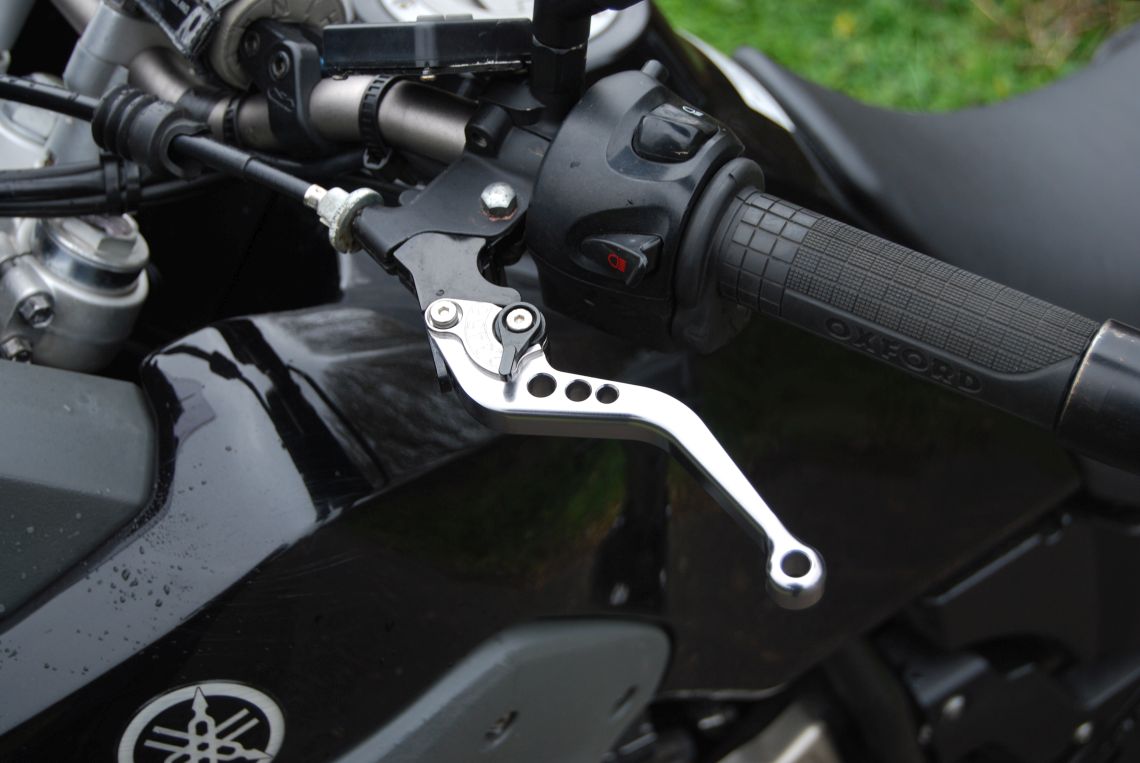

As with virtually every standard Japanese bike, the Yamaha comes equipped with hideously long levers that are just plain nasty to use off-road, so they had to go. A cheap and cheerful set of adjustable span levers were ordered and arrived all the way from the Orient in just eight days, fitting straight on in a matter of minutes.
There’s a lot of forum sniping about Chinese parts, but faced with well-made components for cheap prices, I’m in. Just about every list on Ténéré mods mentions the need to uprate the suspension, and as it’s ridiculously soft on stock settings you can see there is certainly some room for improvement.

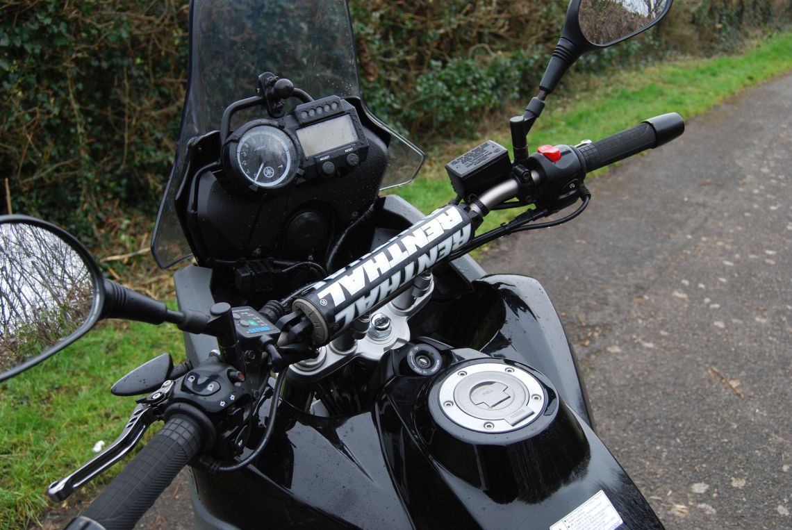

Whether this will be enough remains to be seen. The final addition for the first trip was a USB port to power up the iPhone and allow us to follow the GPX route of the TET that we would be riding.
Although I could have spent time poring over the wiring loom to work out which wires to tap into, I simply ran the wires from the inside of the front fairing, underneath the tank and straight to the battery. To hold the phone, I already had a spare RAM mount which, with a bit of packing, went straight onto the handy bar that runs over the Ténéré’s clocks.
Another eBay foray sourced a waterproof case for less than a tenner and with a bit of drilling and bolting the phone was suitably placed, blocking out the largely superfluous tacho and clearly visible on the fly.
So, with the stage one mods done and the bike a bit more suitably prepared, the TET trip went well, with nearly 500 miles notched up on a fantastic mix of trails, gravel roads, tight single track, flooded byways and somewhat surprisingly, a fair few very extended sections of tarmac.
The near Artic conditions in January didn’t exactly help the Yamaha at times, most notably highlighting that the tyres, most notably the front Mitas, were nowhere near grippy enough for slippery mud over frozen ground.
The New Rubber
The New Rubber
What was also evident was the need to protect the Ténéré from almost inevitable offs that come with the territory of off-road and adventure bikes. I wouldn’t dream of riding my EXC without decent handguards, engine protection and a decent metal sump guard, so those are top of the list alongside the new rubber.
