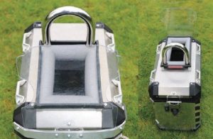

I had initially shied away from using the pannier due to concerns over stability if he were to move around, but it would be possible to equalise his 9kg body weight by compensating the opposite pannier. All I needed next was a spare lid and I could get started on the design, cutting a hole in it big enough for him to get in and out of. I did the obvious and searched eBay and the like, but to no avail. Up to the local BMW dealership we went and, would you believe it, they had one knocking around in the back.
When I got home I cut out the two locking bars and replaced them with a 6mm stainless tube sleeved over a threaded bar with a locking nut on either end. Next was to cut a hole for Skipper, adding extra padding for his neck and to allow him to rest his chin (which he likes to do).
Next, I created a watertight cover which could be placed over him if it rained and a sunshade for the sunny European weather. For this, I used an aluminium angle sealed with marine Sikaflex and bolted on. I then felt the need to fit a roll bar behind his head, and I got this from a company that makes high-quality stainless steel tube products. For eye protection, I built a small windscreen for the lid from toughened perspex that had been recommended for the purpose.

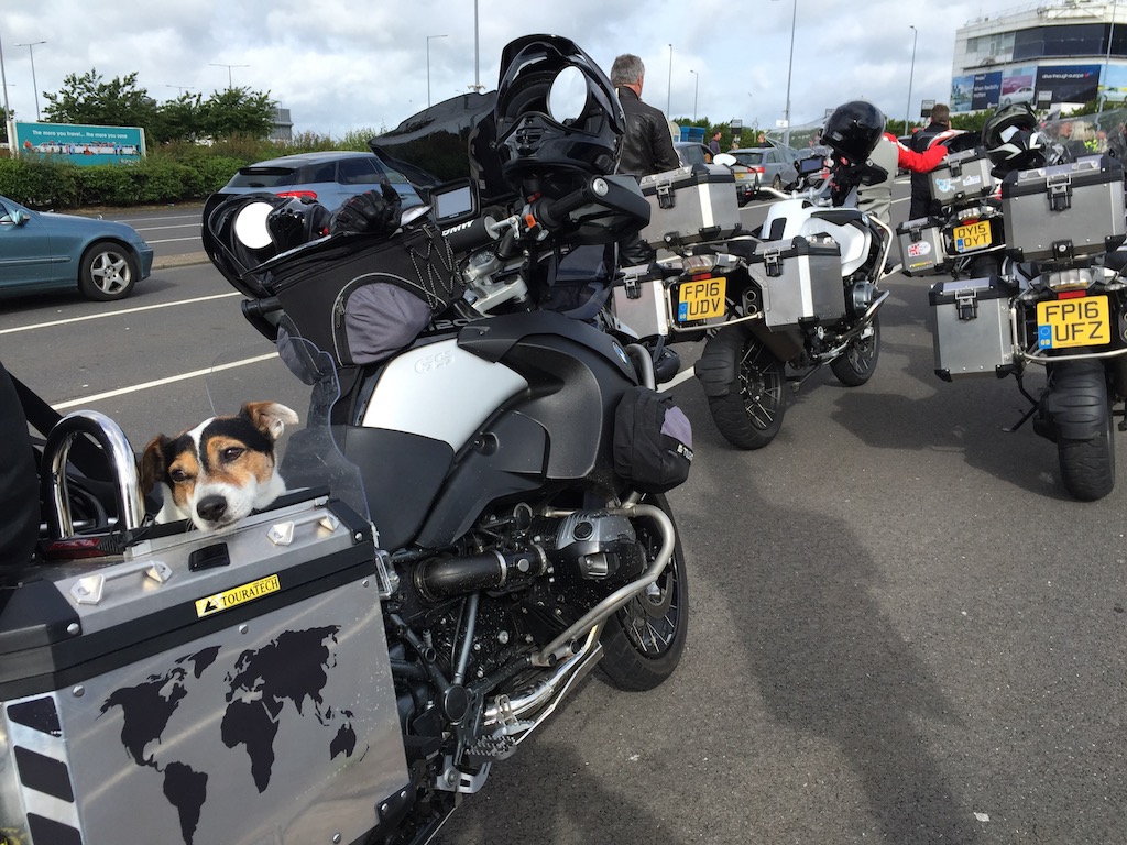

The big question was ‘would Skipper like it?’ He had been in and out of the pannier several times during construction, and he was not disturbed by the fact that he was enclosed in the box, but the proof would be when we mounted it to the bike and went for a spin. On the initial outing, I took my girlfriend, Fran, as pillion so that she could check his reactions. We rode for about 10 minutes and only up to 50mph, and then increased the speed until I was certain that he was happy with adventure riding.
I didn’t notice any difference in the handling of the bike with him in the pannier, it was just as if I had any other kit in it. The thing I really like about where he rides is that the pillion can see and check on him all the time and I can see him in the mirror when I stand on the pegs.
After fitting foam padding and air intake vents on Skipper’s box we did a few 250-350 mile runs to make sure everything and everyone was happy. Before we set off on the 28 June for the channel tunnel, I added a digital thermometer to the inside of the pannier to monitor Skipper’s body temperature.

Skipper travelled very well in the pannier, having plenty of stops along the way to do his wee mails etc. Fran did a great job as pillion and Skipper observer, so all in
all he’s happy riding along with us and it’s great to be able to take him.

So I made a windscreen for the lid from toughened perspex recommended for the purpose.
I simply made a template, traced it onto the perspex and cut it out with a fine-toothed jigsaw blade.
I used aluminium strips to sandwich the windscreen at the bottom for mounting, drilled two holes through the centre of the aluminium strips and Perspex and bolted them through the lid to hold it in place while I heated the screen up with a hairdryer.
I then bent the ends round with clamps, drilled the two ends and bolted it uptight. It looked alright and felt solid, but to be sure it would not be affected under wind pressure I rode the bike without Skipper in the pannier to test it, up to the legal limit-ish on the motorway and it was fine.
I fitted sound recording kit to make sure there was no drumming noise which would distress him. The windshield had minimal flex, but it seemed to spill the wind nicely.
