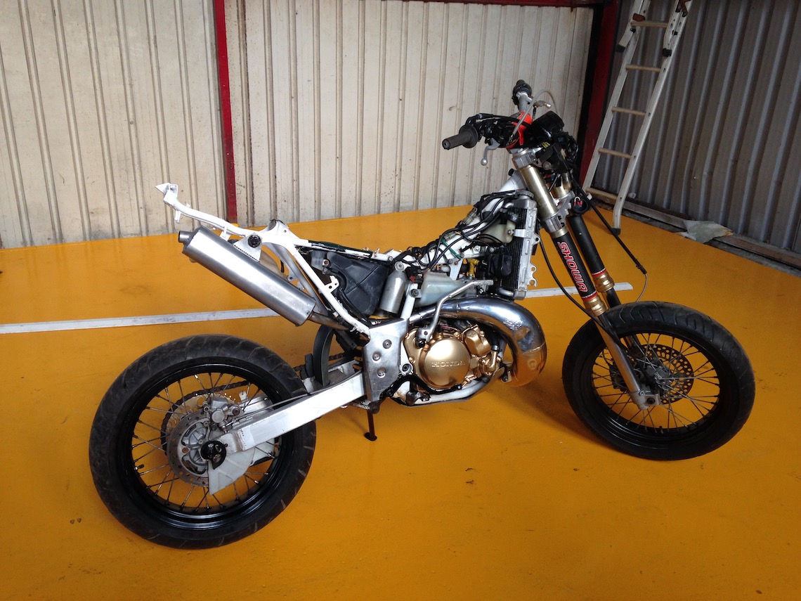

So I decided to strip her down and begin a refurb. My mate had all the supermoto kit, and his dad offered to paint the panels for me. Don’t you love a plan that comes together? We started with the strip down and cleaned the rusted frame, particularly around the rear mudguard.
phills-crm250-issue-34
Phill’s CRM250 stripped to the bone

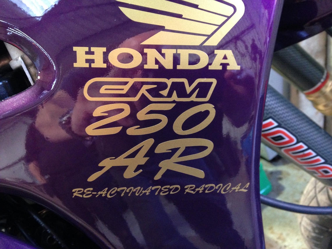

I also resprayed the gearbox casing and polished up the swingarm and exhaust, there were several things missing that I required (pillion pegs, chain guard, sprocket cover) which I managed to source from a combination of bike breakers and Japan. We decided on a lovely purple, very similar to my favourite chocolate, which is an old European Ford colour.
I found an excellent decal guy in an old nuclear bunker in Benbecula, Outer Hebrides. What a surprise, after entering through the enormous blastproof doors to find this small but efficient and very professional decal shop.

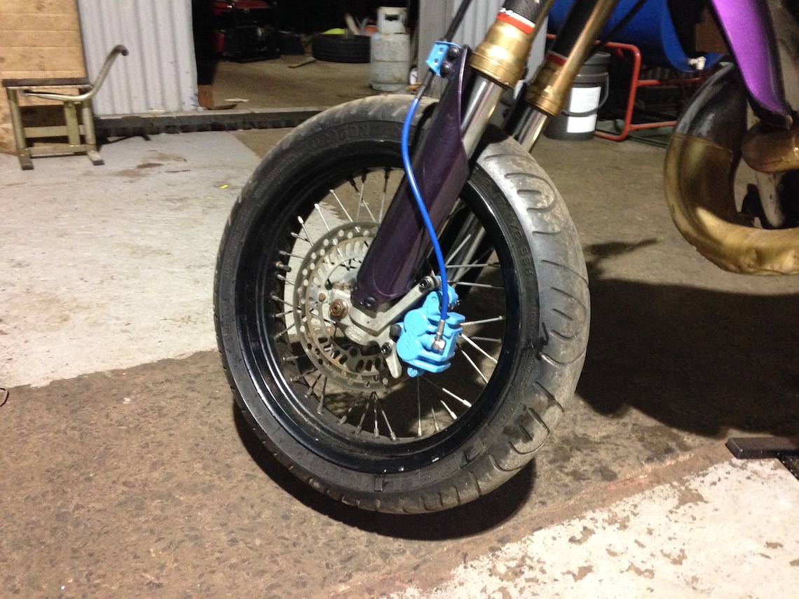

blue-brakes-and-cables-issue-34
Blue brakes and cables
I then managed to get a seat cover to match the paint scheme that was developing nicely now. The contrast of the gold against the purple was so sweet. Not everyone had faith in my vision when I first described it, but after it was completed the pleasing comments came fast and furious.
I wanted to make my bike different and stand out more than average so I went for an additional colour of blue for the chain and sprocket guard, and I also later painted the refurbished calipers in the same colour. Of course, this meant I had to fit a new, blue brake hose.

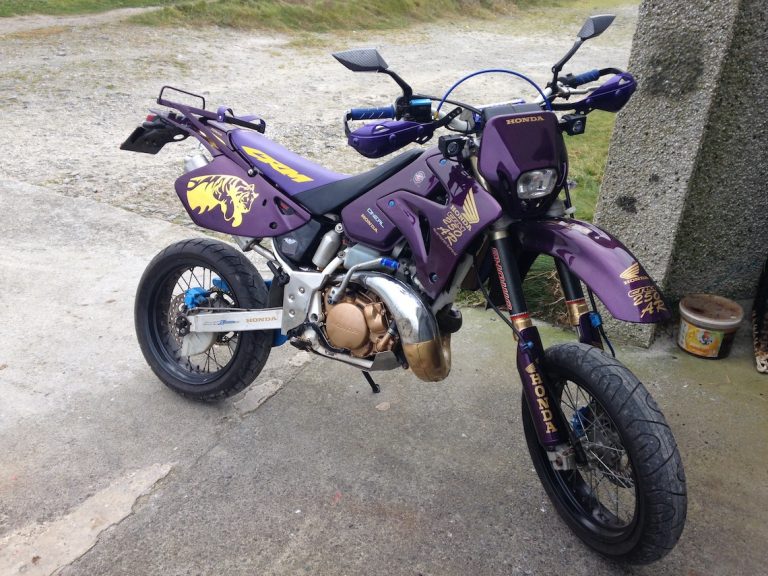

reactivaded-radical-issue-34
Re-activated Radical
The MOT was a breeze with a simple repair to the earth connection on the headlight that was loose giving a very dim dipped beam, the rest was all good giving 150kg force on the rear brakes and over 300kg on the front, which I was told was very good.
