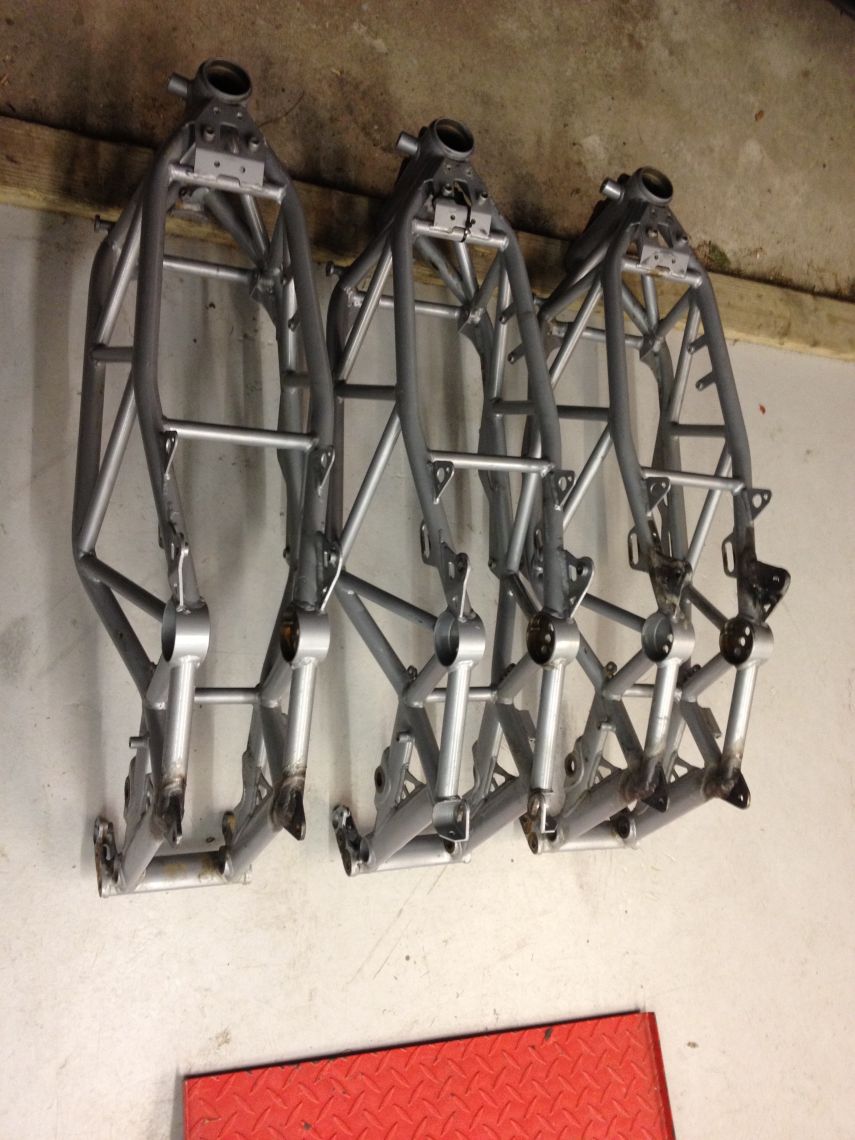

Strong chassis
A Strong chassis is the basis of the bike
Many people get confused and think my bike (named ‘Basil’ after my late grandfather) is a 690 Enduro R, modified for adventure and racing. It is in fact very different. It is based on a 2007 KTM 690 Factory Rally bike, developed specifically to win the Dakar Rally (which they did multiple times). But don’t be fooled into thinking it’s a standard 690 Rally bike. To make it truly ready to race and adventure, I spent a lot of time in the garage making it exactly what I wanted.

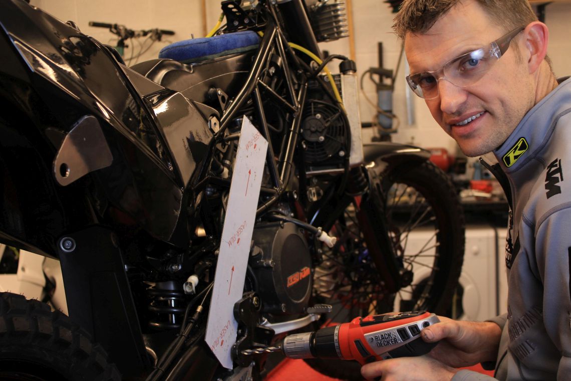

Built from scratch
Lydon built is bike from scratch

I modified the chassis quite a bit also, to add strength for the extra weight of luggage.

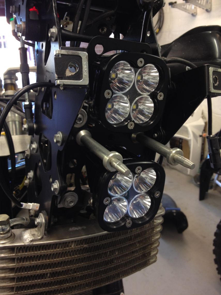

Baja Designs LEDS
Baja Designs LEDs

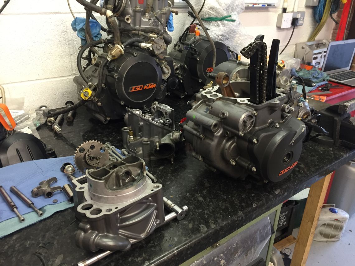

In Australia, in November 2015 I needed to install new piston rings in my bike after 47,000 miles of hard riding. It was nothing major, a simple job, but I opted to increase the size of the engine to 732cc (by increasing bore and stroke) and use a camshaft I had been testing on the dyno with much more lift and duration.
I also installed the Nova Racing wide ratio gearbox which I had been helping to develop (now available from Lyndon Poskitt Racing). The new gearbox has a lower first gear for technical situations and starting, and a higher sixth than all single-cylinder production bikes, meaning I can cruise at higher speeds, with lower revs and get better fuel economy.
The LC4 Engine
The LC4 Engine
We also engineered out some of the little flaws with the production gearbox, like the false neutrals. My engine runs a lower compression compared to that of typical production models, which allows me to run much poorer quality fuel grades, as sometimes 80 grade is the best you can get in the places I choose to ride.
The 730 kit with camshaft, modified combustion chamber and ported head made a big difference and has now been in the bike for 53,000 miles, along with the Nova gearbox. Tried and tested, more power and torque, more fun and easier to ride in all situations. Big smiles.

Then there’s aftermarket parts selection. Obviously, I make a lot of my own parts and components, being an aerospace engineer it comes naturally to want to design and build my own things. I have my own (Lyndon Poskitt Racing) frame modifications, luggage racks, bash plate, footrest hangers, battery compartment, rear rack, camshaft, modified piston, modified clutch, modified clutch master cylinder and a load of other stuff.

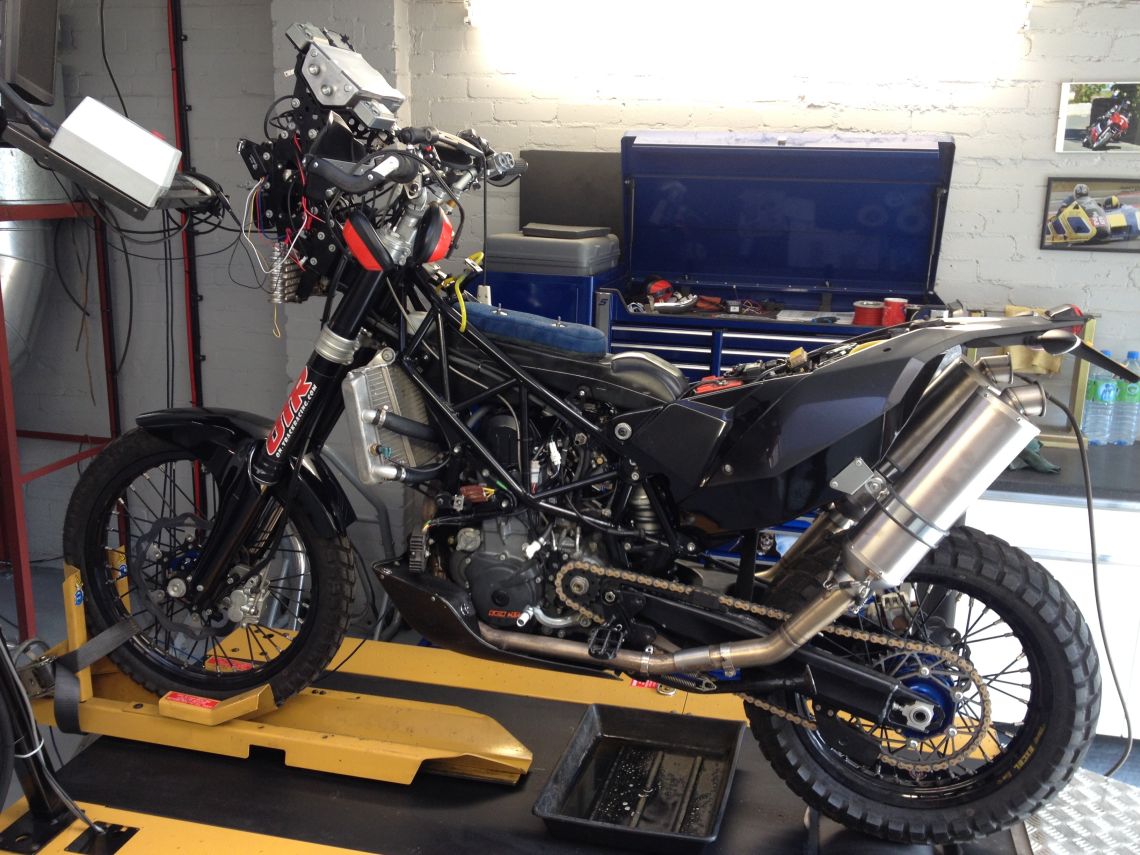

Dyno Tuning Basil Bike
Dyno-tuning Basil Bike
