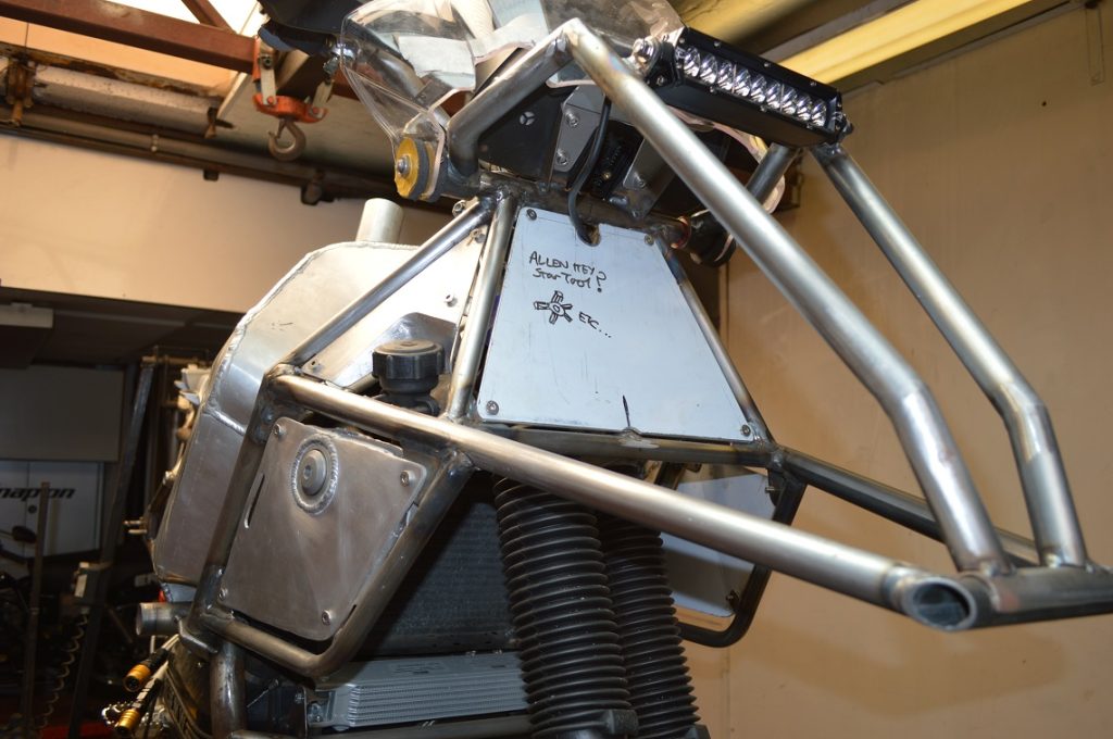

Frame
The frame has had a good seeing to with the hacksaw there’s no doubt there. Headstock has been increased and braced to accept the Aprilia Caponord 50mm yolks. The whole back end is bespoke ‘Axis’ craftsmanship by Colin to accept the GS1200 seats and the luggage system. Front rails have been added to cover many roles including footrests, sump/engine guard, crash bobbin mounts and the fuel cooler mounting.
Final finish will be a phosphorous dip and powder coating in very controversial colours! The front beak of the bike will hold a lightweight roll containing a double sleeping bag and Exped mattress with a hinged affair of typical Axis orientation.

OK, this is where the ‘excess’ element kicks in; I hate having to constantly stop for fuel. As an ex-street fighter builder and an avid ‘Paris Dakar’ follower it left me in no doubt that a custom tank had to be made, of course it had to be big and ‘in your face’ ugly to match the engine!
We have measured capacity and it’s a slightly disappointing 32-litres. This was clearly not enough for what I had in mind. Much consideration and thought has lead us to the idea of an extra fuel pod that would integrate with the luggage, ‘L’ shaped to sit the pannier on. Two of these either side of the bike, one for petrol and a stainless steel one for water (more on this later).
The original K75 tank has a built-in fuel pump so a complete new ‘out of tank’ fuel system had to be designed to give the same pressure (35psi) at the rail.
A classic example of how projects evolve was when a good friend of Colin’s pointed out a much-overlooked problem that occurs to fuel when travelling in hotter climates and that was the buildup of water condensation in the fuel. Being heavier than petrol it naturally seeks a lower place to rest (the reserve fuel pod). Couple this with the classic ‘K’ series puff of smoke on startup issue, we are changing the side stand to the right-hand side.
This will lend itself to persuading any water residue to take up residence exactly where we can decant it away via a well-placed tap which in turn is what I can use for the petrol stove topping up task! There will be a two-stage breather mounted high on the screen that will cater for both tanks.

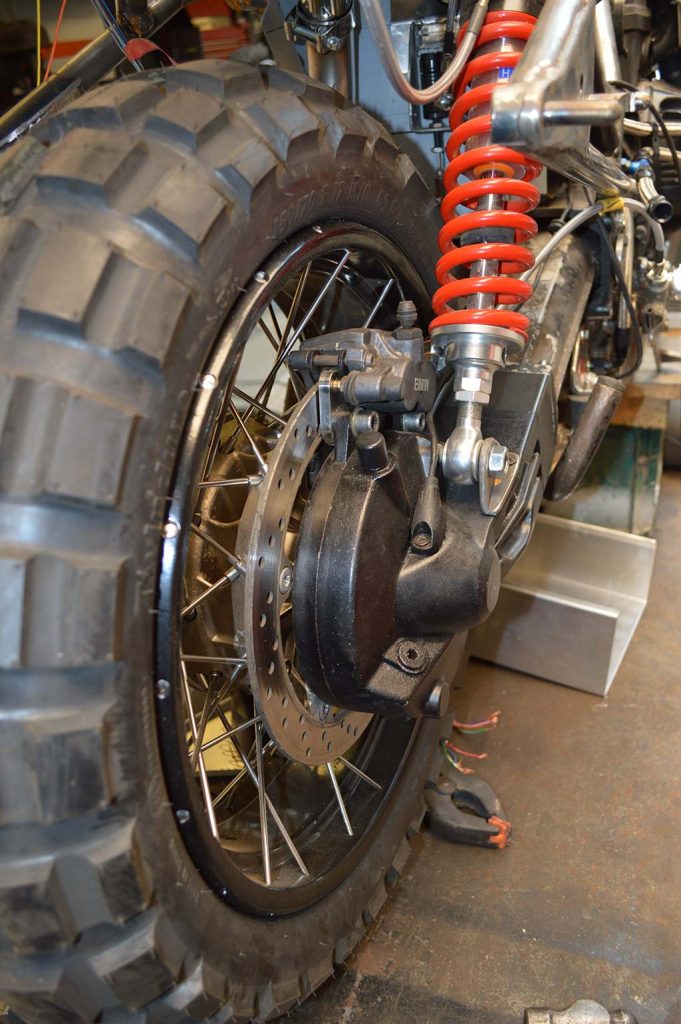

I’m a firm believer of TKC80s. This bike is going to be a heavy old lump there’s no doubt about it and it will also be going off-road. The standard wheels went straight in the skip and the new rear is a modified GS1150 wheel.
The hub has been machined down by 10mm for centralisation and electroless nickel plated, 4mm H/D stainless spokes and the rim powder coated satin black. The rear calliper mounting bracket has been designed by Axis and CNC machined out of billet stainless steel at great expense but I have to say it has given the rear end a very factory looking finish indeed.

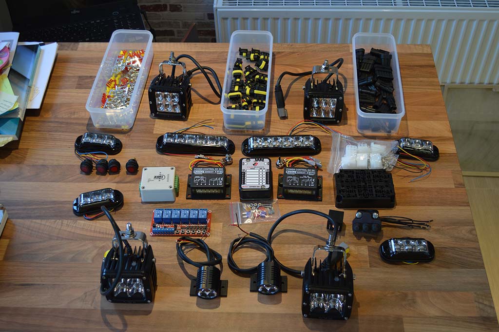

I purchased an array of LED fittings from Gabe at ZEN Overland including a 6” light bar to be perched aloft the beak. Low-level amber spots as fog lights and two mega output spots, one mounted high up which will have the ability to be directed by hand with a quick-release mechanism and the other bolted to a fork brace for more directional accuracy.
Indicators and rear brake/taillights are LEDs sourced from EVS. With all of the gadgets being added, we’ve had to create space to mount it all. The ‘Electric Box’ has stolen some capacity from the extra fuel pod but solved the problem we had from the space-hungry design of the Axis frame.
