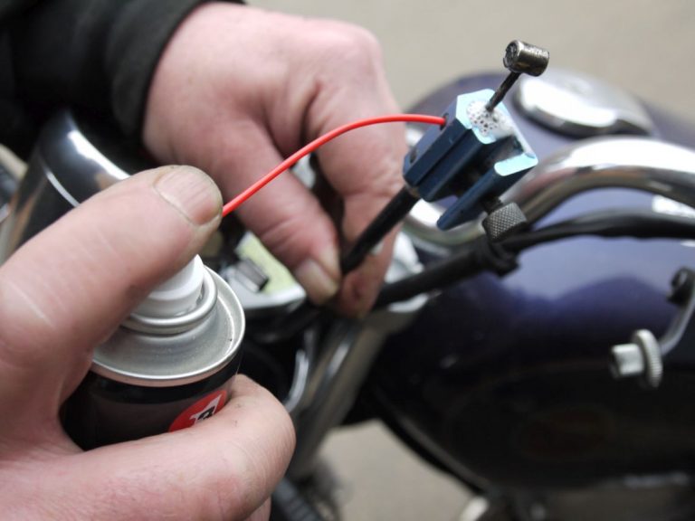

Clamp on Lubricator
A clamp-on Lubricator makes it an easy process
Prevent future damage by taking care of your cable. They like to be lubed. Do this with a small clamp on lubricator, they use an aerosol to force oil all the way through the cable. To install, simply disconnect the cable at the lever end, attach the clamp carefully and squirt away. Do this until you see lube coming out the other end, job done, your cable is now nicely lubricated.
What lube should you use? I’ve used 3-IN-ONE for years but you can also use a light machine oil and some of the modern Teflon sprays are good. Not WD-40 though, it’s undoubtedly a great product but it’s not intended for use as a lubricant.

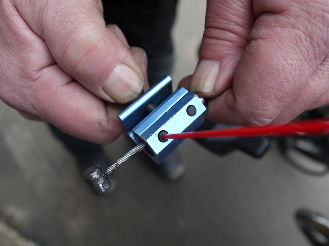

Solderless Nipples in your tool kit
Keep a few solderless nipples in your tool kit
Most breakages occur at the end that gets the most strain, that being the clutch lever end. Pack a few solderless nipples of various sizes in your riding tool kit and you’ll be able to use these to replace the damaged one. Just trim the broken cable with that multitool you got for Christmas years ago and if necessary shorten the outer sheaf a little to aid the fit.
If your cable breaks and you have no solderless nipple an electrical terminal strip can be very useful in an emergency and they can be picked up for pennies online or in a hardware store.
