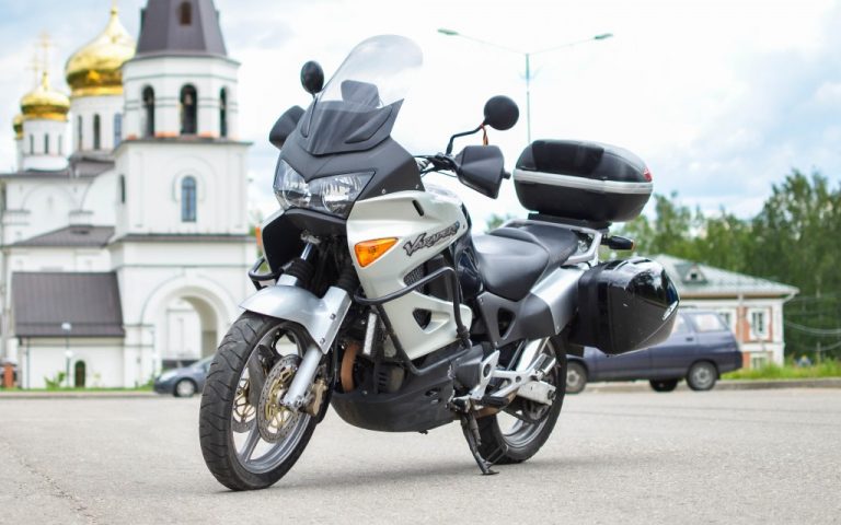

Since the hot weather started, I’ve noticed a strong smell of petrol from my bike. It’s an early 2001 Honda XL1000V Varadero. I’m a bit concerned as I’m off for a two-week tour of France soon.
