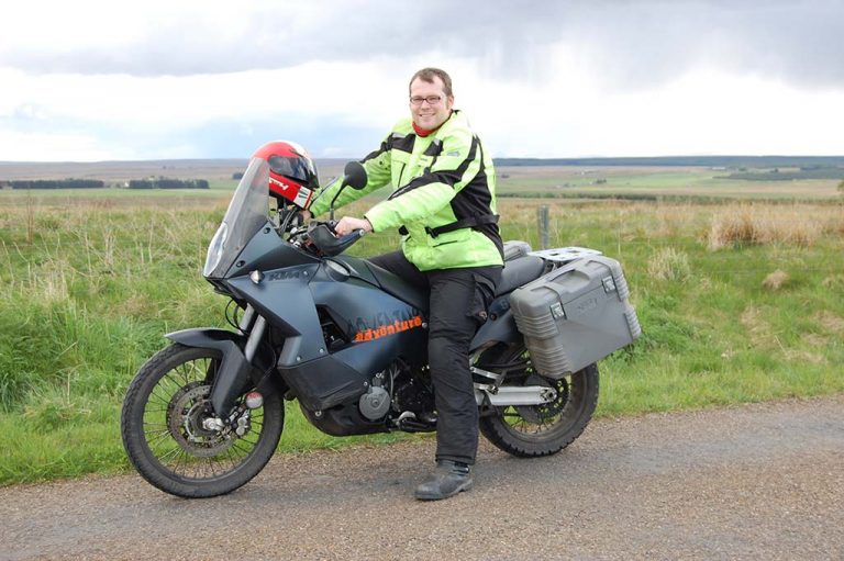

Q. I have a 2006 KTM 990 Adventure as my first big bike. I’ve always wanted to travel long distances in the UK, Europe and perhaps even the rest of the world on a KTM! However, I’ve lost count of how many times I’ve refuelled the bike so far. It appears to have a fuel tank range close to 120-130 miles which for an ‘around the world tourer’ is rather pathetic. The bike is fitted with Akropovic exhausts so I’m guessing this would affect fuel injection/mapping, is that right? How do I make it more fuel efficient?
A. Expert motorcycle mechanic Simon fear at Arden Motorcycles (www. ardenmotorcycles.co.uk) says: While the 990 is an excellent bike, fuel economy is not its strong point and with spirited riding it will only return around 35mpg a tank range of around 150. I would make sure that you are filling the tanks to the top as the odd shape of the fuel tank neck tends to hold fuel when filling and it takes a while for the fuel level to settle. Each fuel tank has its own breather pipe which can get trapped when refitting after servicing. This causes a vacuum as the fuel level drops and will prevent fuel flow. The bike should run fine with the Akropovic pipes, but it would be worth checking the spark plug colour to make sure and, most importantly, make sure the air filter is clean.
